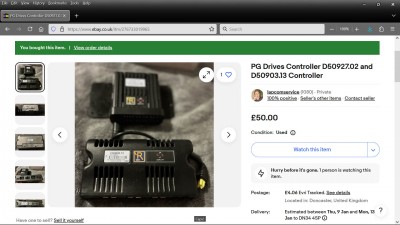

80 offered, accepted.
£50 paid, cables, PM and Seating module...

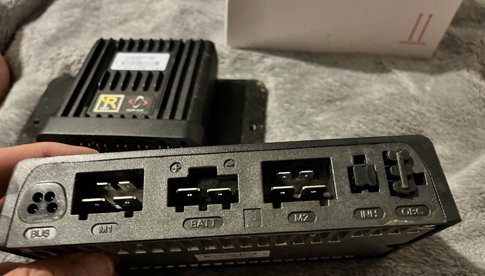

Re: How to use a clamp meter?
Postby Burgerman » 25 Jan 2026, 10:22
Note.
There are 2 different VR2s that have either identical connectors to R-Net, so plug and play. Or a diffferent one. I THINK sunrise use the common connectors one so that they can offer either R-Net or VR2 on a chair and its plug and play. Check.
Do your motor and battery connectors look like this R-net, if so plug and play:
Postby faico_26 » 25 Jan 2026, 15:35
Burgerman wrote:Note.
Yes, I think so, because when ordering the chair they give you the option to choose between VR2 or R-Net so I guess it's the same connectors. I have checked again the ordering form on Sunrise Spain webpage and I noticed the R-Net they offer on the order form a 90AMP unit. It's always the same, they offer the minimum and paying a fortune. If you want the 120AMP then you have to pay even more. The VR2 90AMP system I have is included in the 4500€ the chair costs.

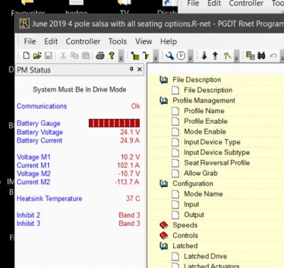

Postby Burgerman » 25 Jan 2026, 18:01
Why?
Because to be USEFUL you need to understand the relationship between pulsewidth, battery current, and motor current and also be able to read simultanious current in 3 places while watching the voltage at motors (a 50% pulsewidth or half throttle which happens even at a 10% stick movement due to compensation is 12V) and see what that does at the battery.
The battery in the chair below is already being pulled down to 24.1V which would be "all the lights out" if it wasnt averaged, while pulling only 24.9A from it.
And because of the pulsewidth the controller is using then the motors are both well over 100A/113A each. And look at the motor voltage, that is the proxy for pulsewidth. Or the amount of "gas" the controller is applying due to load. (compensation) In this case turning in my hallway in place.
Look at M1.
Its 10V (around a 45% pulsewidth) and because almost stalled drawing 100A plus. Thats a 10 to 1 relationship. If the controller sent 20V (ABOUT 90% pulsewidth) that motor would pull 200A. The controller cant do that though... This motor must be turning.
If compensation was set higher, it would be sending around 12V and 120A. And would turn in place better.
Look at M2
It has 113A and still only 10.7V. So that motor has either a lower impedance (maybe colder) and is pulling more than 10X the voltge in amps. But these are both cold motors. So that means that THIS motor is turning slower or stalled as its drawing more amps per volt than the other one.
I also see that theres no thermal rollback as the mosfets are just 7C warmer than my house was.
Your controller will heat up faster because its using "smaller" higher resistance mosfets. So yours may roll back power sooner.
Thats what I see here.
