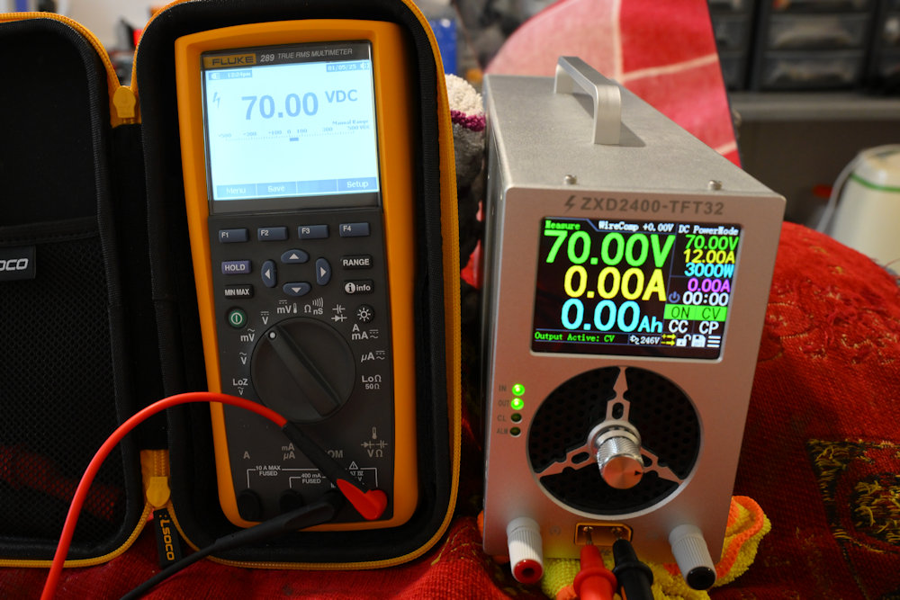

ZXD is supplied already converted by forum member Shirley in HK. I have 2...
Also its super accurate over a very wide range, can be set with a proper termination current, switch to a 2nd float voltage, and has timers etc built in that allow correct configuration. For gel, AGM, etc as well as 3KW of output capability and so great for charging lithium too.
See:
https://www.wheelchairdriver.com/board/ ... 70#p115228

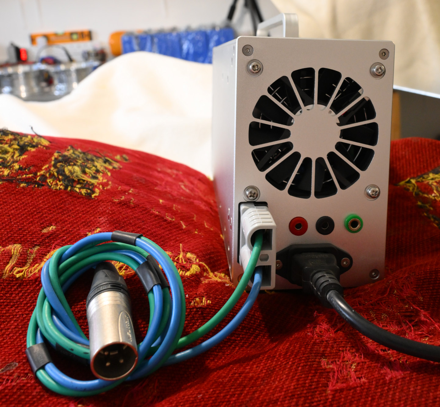

This is both a POWER SUPPLY as well as a very user configurable 3 STAGE CHARGER.
It can do anything from 0 to 50A if powered by 240V as mos of the world. Or 0 to 25A if powered by 110V AC.
And can do 0 to 60V output. Actually it can do up to 70V if configured correctly on 120 or 240V AC.
This is bomb proof, a converted telecoms rack mounted unit. And super flexible. A lot of options!
Anderson to Anderson on chair must be used for high current charging
between matches, not XLR charge port on chair. That is limited to 12A MAX.
Voltage accuracy
Voltage accuracy

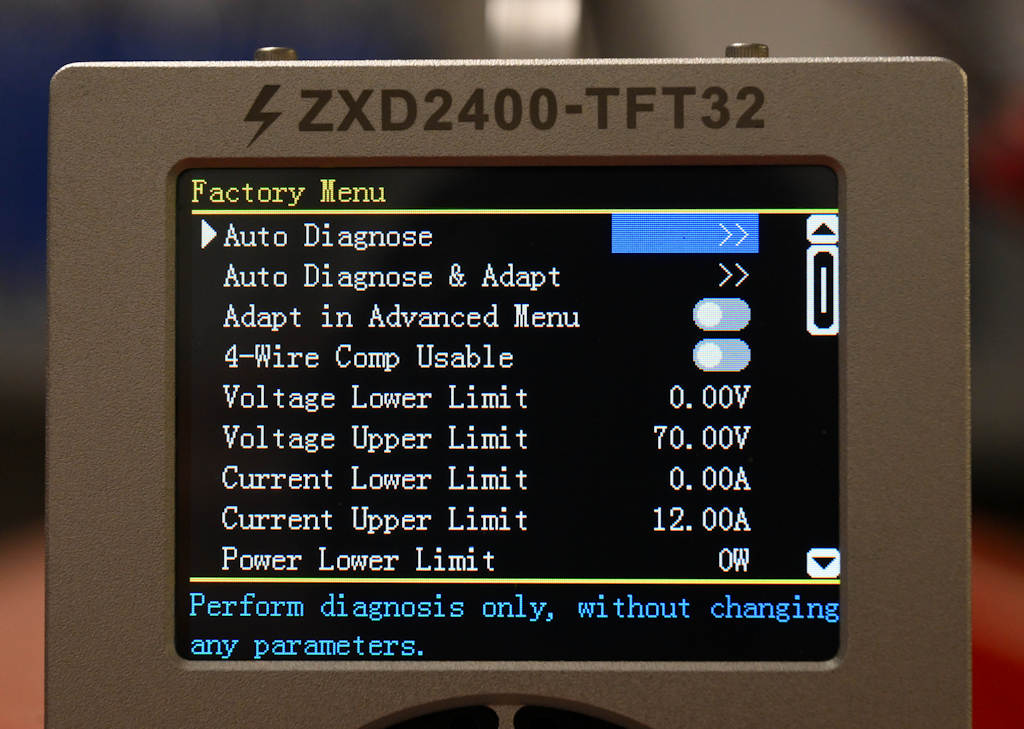

There are extensive menus if you wish to change or limit things. Pages of this stuff!
But you dont need to.
But THIS ZXD is set to 12A maximum, so that I cant inadvertently set / send more Amps to
the XLR joystick charge port! For safety.
