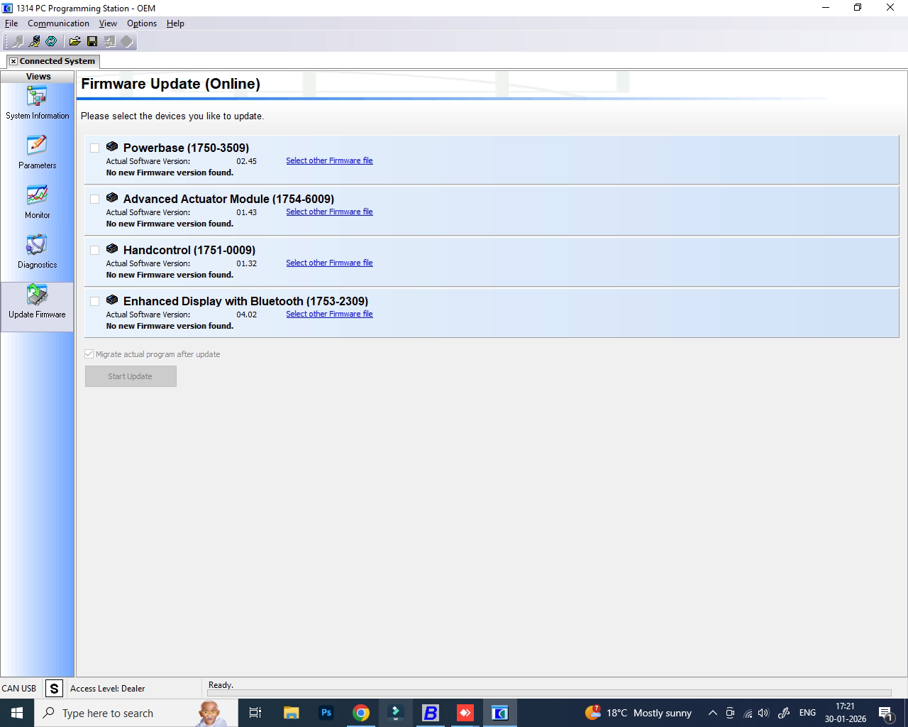

I have a Quantum 600 with a Q-Logic 2 Powerbase (v02.45). My Enhanced Display (1753-2309, firmware v04.02) is showing error #251: incompatible firmware.
Would anyone be able to share the compatible .cag firmware file (v04.00 or v04.01) so I can downgrade the display to match the powerbase?

Yes, you're right—Pride/Quantum is just the OEM for the chair, but the Q-Logic electronics (including the Enhanced Display) are all Curtis Instruments under the hood. I appreciate the clarification.
I do need the firmware (.cag file) specifically for the Enhanced Display module (model 1753-2309). The chair's Powerbase is on v02.45, and the display I added is on v04.02, which is causing the "#251 incompatible firmware" error when connected. From what I've read on the forum and Curtis docs, downgrading the display to v04.00 or v04.01 should fix it, as those are compatible with Powerbase 02.45.
I have the Curtis 1314 dealer software and a programmer cable, so I can flash it myself (via the Update Firmware menu—I've done settings changes already, but I don't have the required cag files for the enhanced version). I also attached a screenshot for your reference.
Mainly I need the enhanced display firmware to get it working so I can set up my MicroGuide joystick properly.
