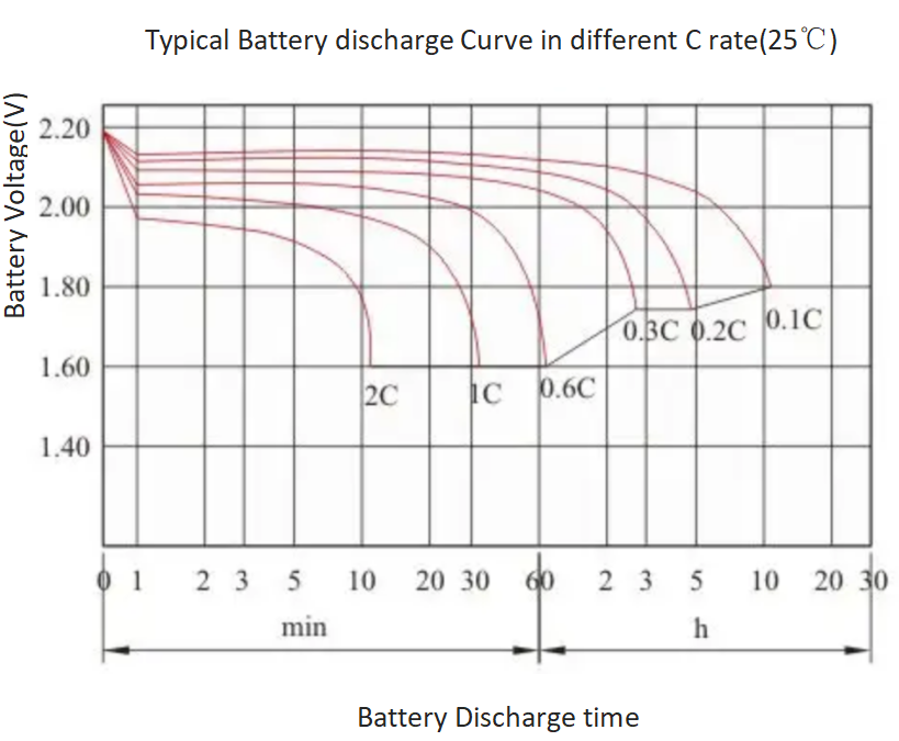

Postby Burgerman » 20 Feb 2026, 12:38
Lead battery capacity at 1h rate. (your trip into town)
With lead he faster you discharge it the more energy is wasted and the less capacity it has.
The same happens on charge too. Worse, as you re-charge a sealed battery they make gas. Thhe more chared it becomes, the more gets wasted. That takes energy to split the water to hydrogen/oxyg. They then recombine this which takes more energy... When a battery is almost full it spends another 8 hours with a small current where 99% of it is wasted. But must still be done. Unless you want instead to stop charge early and have 12 hours at float to add to the charge.
So look at this discharge graph. It shows the difference in capacity between a slow "20h rate" battery. And 1 hour.
Posts: 71101
Re: Back to lead
Postby Burgerman » 20 Feb 2026, 12:53
Now that means at an AVERAGE constant rate 1 hour rate, discharge you get 0.5 or 50% of ts capacity.
But we dont take current at a constant rate. We take big bursts. Then lower amounts. During the big bursts, so when we accelerate, turn in place etc with those heavy lead batteries that voltage may drop well below the point shown on the graph. Its possible if you give it some, that you can reach 3C. Thats a really low voltage below which the chair will deliver good power. It drops below 18V. And during thise big bursts you have higher peukert levels too. Further reducing actual range.
As I said many times. Once used to lithium, lead is just a waste of time. Its not just range. But weight. And charge speed and efficiency and a couple of decades of lifespan. And its CHEAPER today as well!
Lets put this differently.
Lithium batteries are all rated at the 1C rate. So a 100Ah battery is 100Ah at 100 amp discharge rate for 1 hour. And it doesent much matter or change anything if you do that over 20 hours ts still 100Ah out.
Lead batteries are not rated at the 1 hour rate. If they were the typical 100Ah (@ 20h rate) lead battery would be a 35 to 45Ah battery...
But in a chair that does 10kph, covers 10km, in 1 hour then that 1 hour rate matters!!!
Posts: 71101
