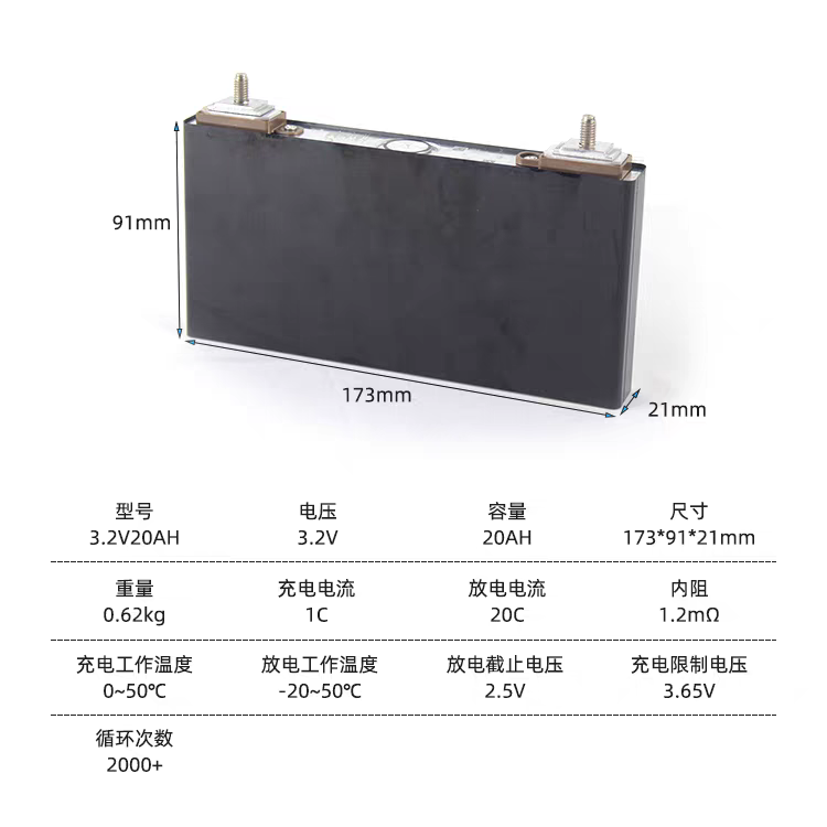

Postby shirley_hkg » 22 Feb 2026, 03:25
Panasonic LiFePO4 20Ah
20C rated.
