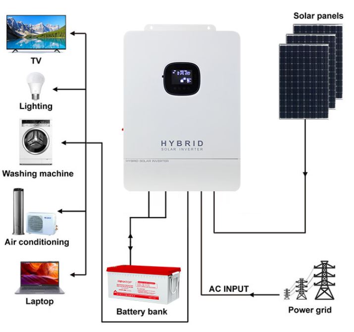

I have an ancient Permobil c300
is it possible to somehow use it's battery as a power station to power some vital things like my inflatable mattres or my laptop? I can't afford additional batteries
I'm thinking maybe I could use a hybrid charge controler/invertor and connect it directly to the batteries (not the wheelchair joystick's port)
this way I'd also be able to charge batteries via sollar pannels if they blow up power plants
my concern is if it's going to harm/fry wheelchair's electronic? I mean, hybrid charge controler is going to charge at ~28V (connected directly to the batteries). I know very little about Electronics
hybrid charge controler/invertor :
https://www.epever.com/product/upower-1 ... r-charger/

that's exactly what I need to do.power my devices with my wheelchair 's batteries
EPEVER® UP2000-HM6022 Inverter Charger let me power my devices with it's invertor and it's capable to charge my batteries with it's mppt charger via solar or 220v AC. but I'm afraid If I connect it to my batteries and blow up wheelchair's board because both wheelchair and EPEVER are connected to batteries at the same time
the red battery would be my wheelchair

The reason a battery charges is because the voltage from the charger is HIGHER by a few tenths of a volt than the battery. So it flows in to the battery untill these match. Then its full.
The reason the battery can run things is because you apply a load (a resistance) which tries to pull the voltage down.
You dont need a fancy seperate device. Inverter charger/solar inverter/AC out.
You can connect a solar charge (simple, cheap) straight to the chairs BATTERY.
You can present a load to these same batteries either while charging or when not charging, seperately by using a simple cheap AC inverter to get 240V.
The chairs controller or electronics are not involved and so just dont care.
However you are not realistic. A chairs battery is about 1kwh. If its full. Thats WAY too small. You need around 10x this. And you will need around 3 to 4KW of solar panels to keep up. In summer. In winter forget it.

Burgerman wrote:The chairs controller or electronics are not involved and so just dont care.
That's the part that I don't understand.
In your scenario the mppt charger and the wheelchair itself are connected to the batteries at the same time? or you mean I “have to” isolate them with Anderson connectors ?
my concern is when I'm trying to charge the batteries with mppt charger and the wheelchair is connected to the battery also, I hurt the wheelchair board

Postby Burgerman » 26 Feb 2026, 13:17
No.
You can connect a CHARGER. Solar or AC or whatever...
You can connect an AC inverter to run a fridge, charge a different chair, run your TV...
The powerchairs controller is not involved and does not care!
Its all perfectly fine connected and working at the same time. All 3. Charger. AC Inverter. Chairs controller. and you can add a solar panel, or whatever you want all at the same time...
But you charge it at night anyway right? That doesent hurt the wheelchairs board does it? Why would you think an MPPT charger is any different??? Its not!
However your chairs battery lacks the Ah capacity to be very useful to run anything of consequence for long.
