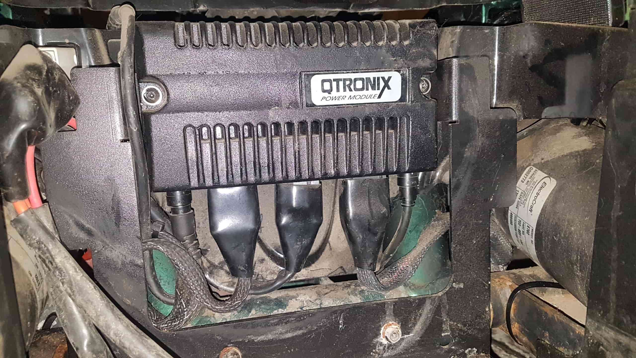

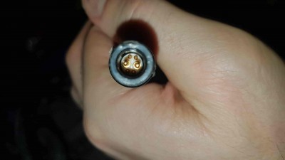

I made a error of judgment tonight trying to cut corners to save time.
I tried to take the volt mesurement of the chair inside the redel connector instead of somewhere else. I know so little space.
so the multimeter sticks created a spark . The joystick was disconnected. the chair number is S64-041628. quickie 646se.
When I Tried to connect the redel to see if it still works I think there was some light in the joystick but the problem is that I could not connect the redel connector all the way in because apparently the short has added a layer of something ? that might makes it so that it does not want to fully penetrate the other part. Also there is a very obvious black color inside the redel where the spark happened. Maybe the black color is a layer of something . see pictures of the black versus the picture of another redel connecter I have . The male redel connector from the old chair(same model) accepts to connect with the joystick I am using.
After the chair's joystick was disconnected for like 15 minutes I heard a weird noise that I dont recognise. I thought that it was coming from the multimeter but that loud I think it came from the chair. Is it possible that after x minutes joystick disconnected the chair 's computer module emits a sound ? Also after the sound I tried to touch connect again the redel and there was no light in the joystick anymore if Im not mistaken I was stressed so memory not sure for this.
1)If there is something to be done to start the chair's computer module please let me know so that i Know in advance because changing batteries everytime is consuming .Will I have to also do the magic formula of joystick forward backward something like that?
2 )A short like this has created a problem to the redel connector yes but could it have damage the computer or other components? how to verify? maybe a damage to a fuse or breacker?
3) How to resolve. the issue? I have an old chair same model. Both are Q tronix. I see these ways. Let me know how realistic each of them are.
A) To clean the black stuff from the redel . Ish , there is not a lot of space in there, The male extremities are tiny , I dont have specialised stuff to sand that and if the job is not done properly, that might bring some black stuff inside the female part going into the joystick. I have
Hosa Caig Deoxit Contact Cleaner 5% Spray 5 Oz . But is that sufficient? We dont know what prevent the 2 parts from penetrate each other.
B) It is possible to disconnect the redel cable from the computer part I did it once . maybe I could buy one or take the one from the old chair and put it on the working chair? How to test the redel from the old chair or one that i would buy used. I have this multimeter Proster Digital Clamp Meter TRMS 6000counts, 800A DC AC Current AC/DC Voltage NCV Continuity Capacitance Resistance Frequency Diode Hz Test,
C) Maybe I could take a cutter and cut the broken redel cable close to the redel connector, cut the working redel with a bit of loss cable and solder it on the working chair. Now I never opened redel cables. I imagine there are 6 wires? are there 6 wires? Are each of the wires colored with a different color that would make it so that i could not make a mistake while soldering them with the 6 other wires? The downside of this one is that it makes de old computer module not ready to serve and almost ready to garbage , it lessens it.
D) I could buy a new redel cable but it brings me to question B and adds costs.
E) I could switch the computer of the 2 chairs but that comes with some wires manipulations and a I am not completely certain the computer from the old chair is in working order.
F) how easy is it to install just a male connector to a wire. I could cut the cable very close to the redel connector and install a male one. how easy is it . The videos I see are about metal connectors but the this redel seem to mostly be in plastic. Anyone tried to install one before?
I think the option B would be the fastest
LEt me know that you think

Where to start...
The layer of "something" you are talking about is metal that the short has welded in place in the male or female part. The black is a sotty deposit caused by vaporising metal with electricity.
If it were me. I wold throw it all away and fit NEW batteries and R-Net.

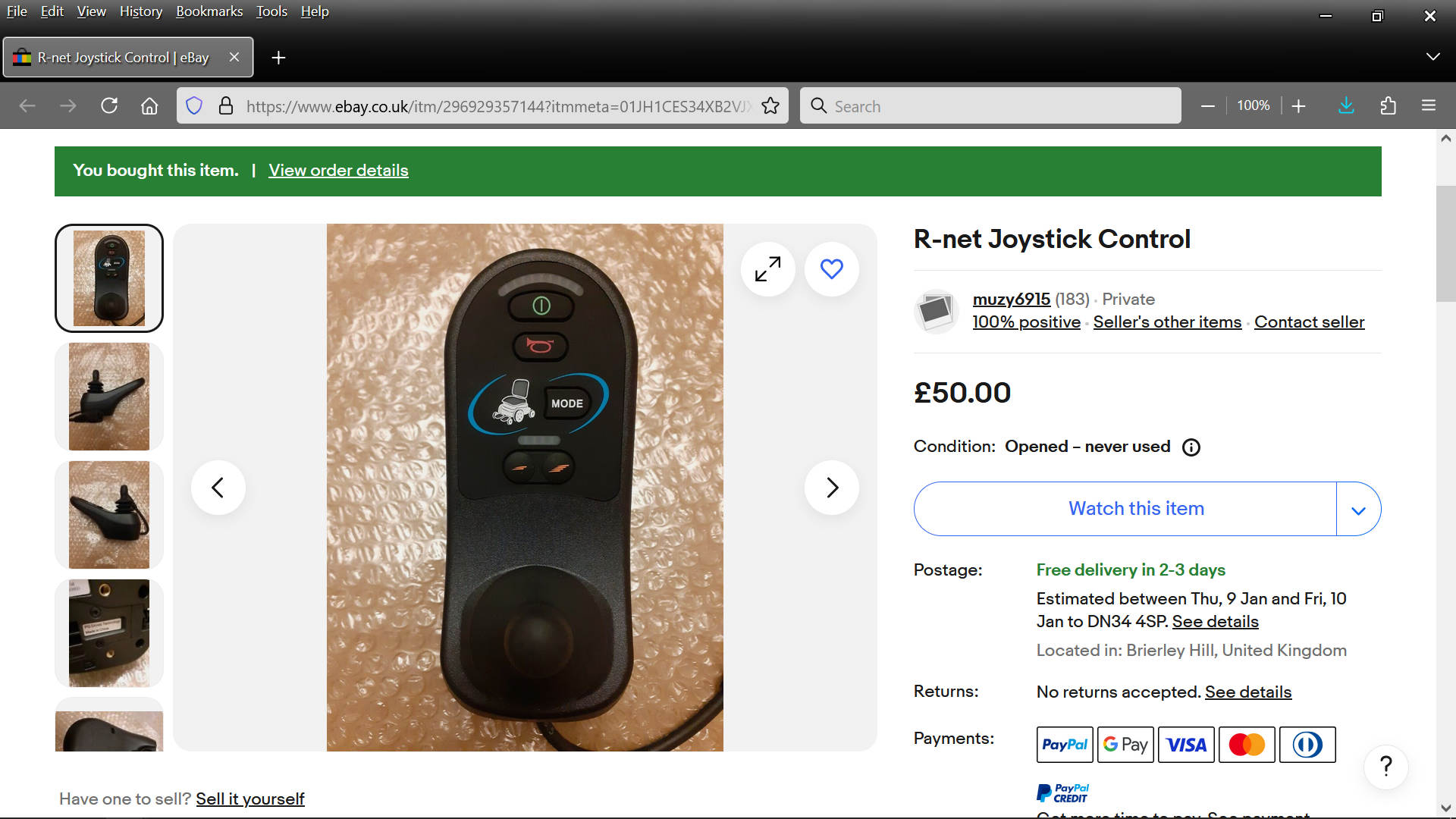

I paid 40 (offer accepted) for a brand new on here:
So a complete system, inc seating etc £90...
£40 offer accepted. Brand new.
