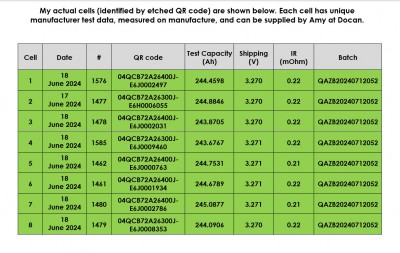

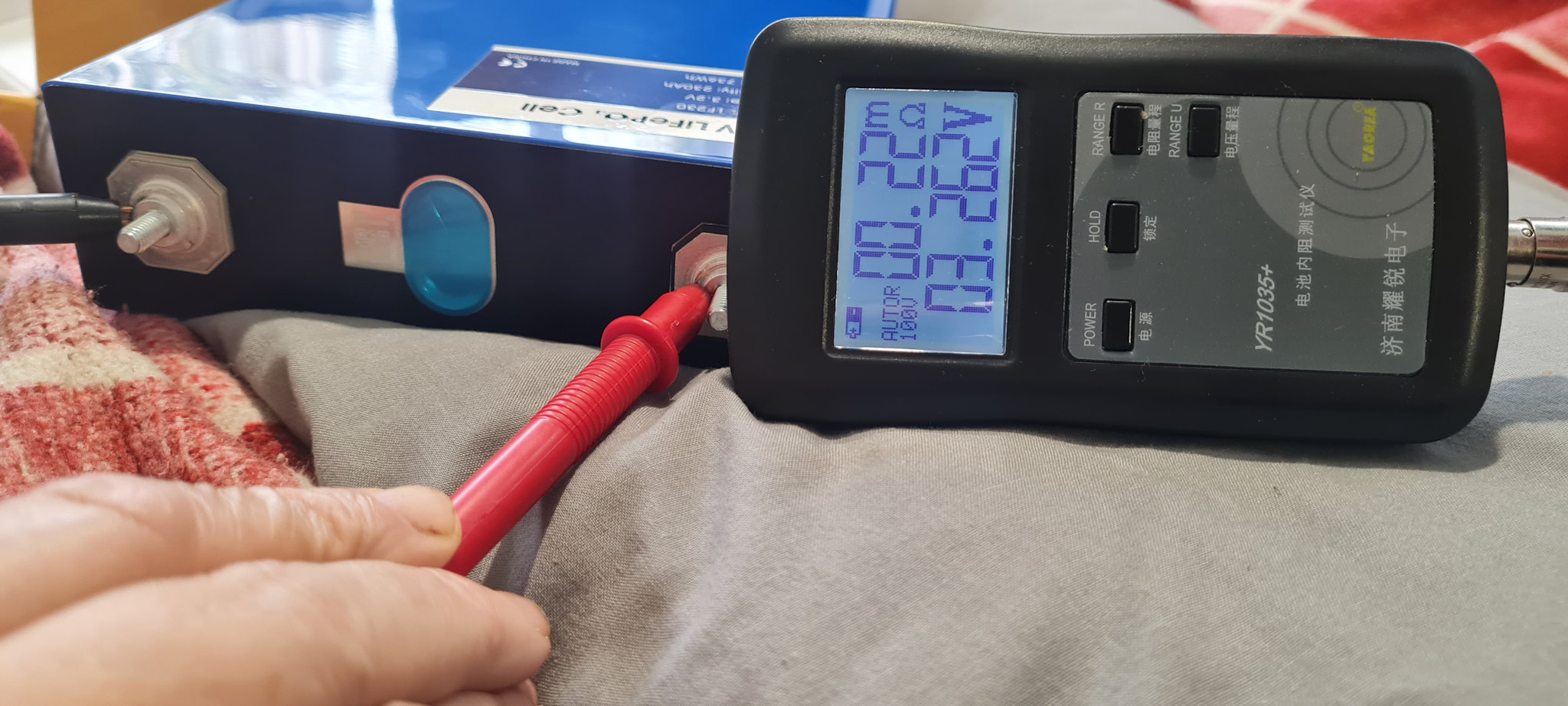

Mine EXACTLY match the cell number code. And manufacturer test data for my actual cells.
Resistance is all important, and capacity measured on PL8 was within better than 1% of the claimed 244Ah capacity on the 4 cells I bothered to measure.
It doesent matter if they claim .5C 1C or 3C just look at impedance per Ah. 0.22of a mOhm here. Its the only way we can compare. @ half charge.
So under 2mOhm for a full battery.
