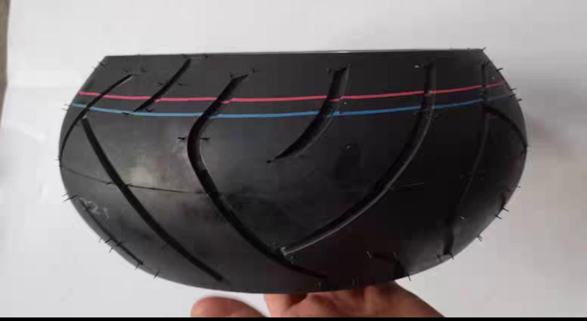

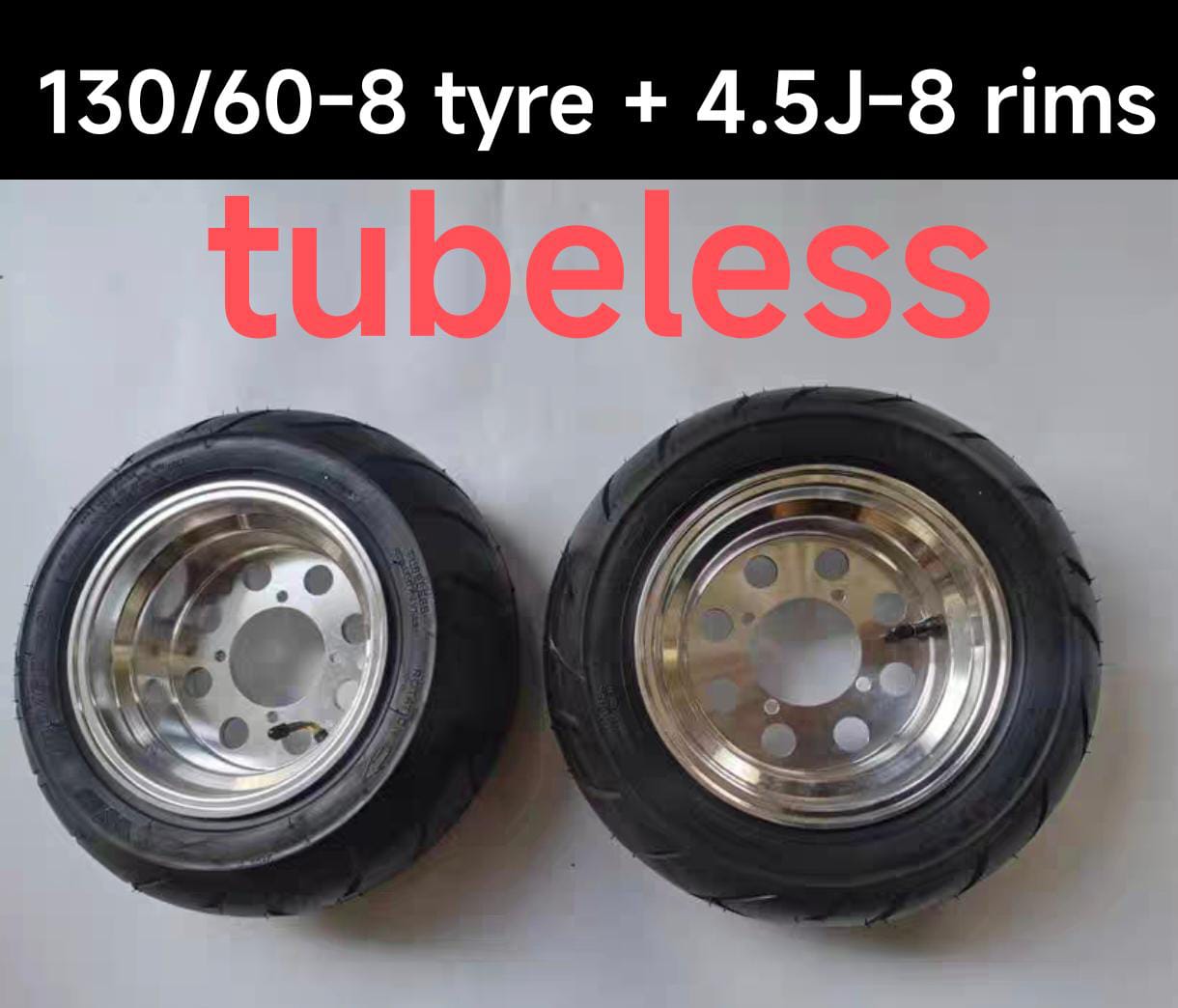

Many here have fitted wider rims. And myself have done that to every chair I ever owned. And thats a good few more than 10... Every one was a custom modification. All done in different ways. Mostly to allow me to use tubeless tyres. There are no plug and play easy bolt on solutions. Every motor/chair/rim is different. And needs to be looked at as a seperate modification.
Were from?
Aliexpress, ebay, minibike suppliers, turf tyre suppliers, japanese custom monkeybike supplies, etc.

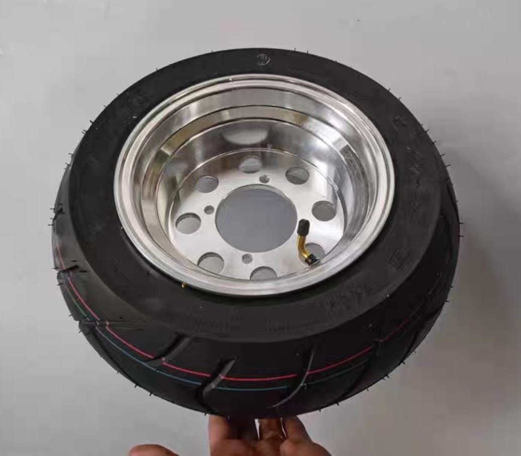

Can you get me a price inc shipping for a set of those?
130mm / 60 means a 60% profile.
So thats... a 6.142 inch tyre height in case anyone is wondering. So 8 rim + 6.1 = 14.1 inch total diameter.
Prefer 15 as most of mine are but its enough.
The tyre quality isnt great either. But cheap + its the size...

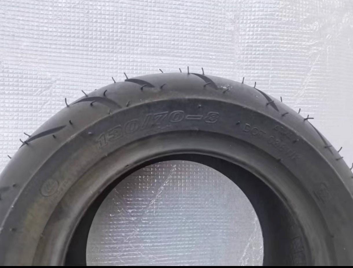

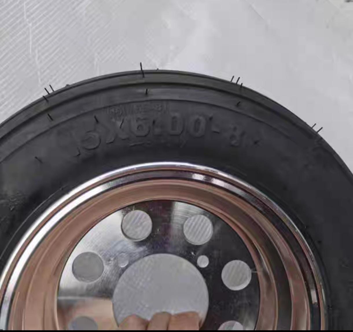

130/70-8
and
15*6.00-8
