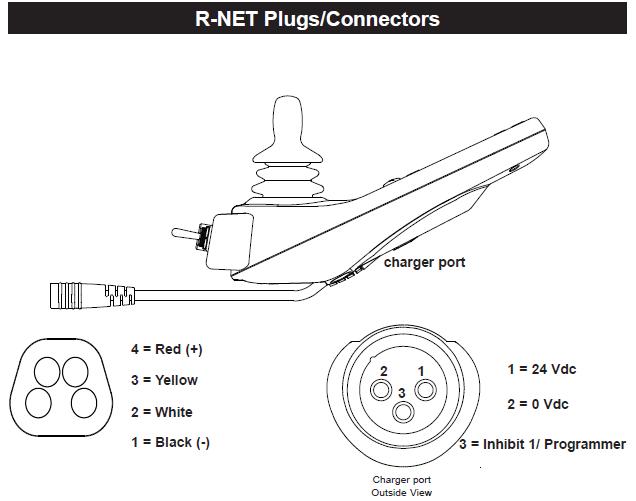

I can see no reason not to try this interface with the R-Net...
I'll happily post the interface to anyone that wishes to try it.
