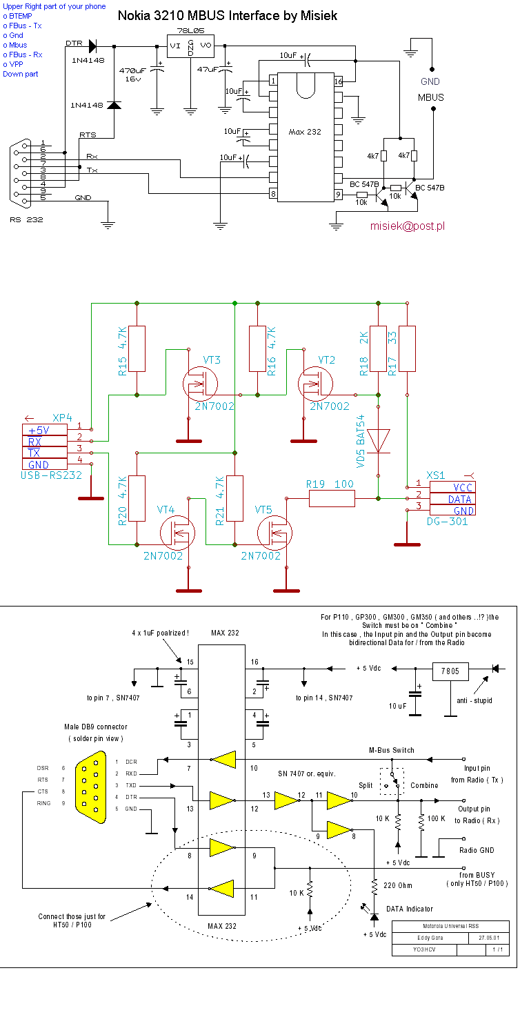

The problem is in finding a lead that communicates with the PGDT controller and will thus allow programming of it.
1-wire communication ....
Re: PGDT interface update
Postby vr2hacker » 18 Jun 2012, 22:27
the FTDI cables should work the same, since they provide the same signals as the PL2303: RX and TX at 5V TTL levels.
The Kenwood isn't really one-wire, since the technique is to tie together the RX and TX lines, but I know what you mean.
I'm hacking a VR2 for a robot controller and trying to figure out what they did in hardware to complicate things!

I don't know about doing the straight from USB - controller setup, but the FTDI USB -Serial adapter, and the standard P&G serial cable has been reported by others to work on at least some Microsoft platforms, and I just got it working under VMware on a Mac... So I wouldn't be terribly surprised if that was a workable approach.
I don't know how it would like having it's TX & RX pins tied together though, I could see how that might confuse it. There might be a need to have some kind of protection on them. However the technical reference info is probably going to be easy to find, so that should be an easily answered question...
You do need a few extra components to divert the signals ... the Kenwood cable appears to have a version of the middle schematic tacked onto it's RX /TX .
3 onewire.GIF (34.54 KiB) Viewed 94123 times
