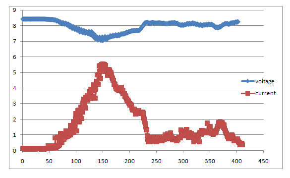

I didn't touch the compensation on my P&G, so perhaps you're right that it could be better. What I did was measure the current at 100 hz, and plot each point to see the time it took to move from zero to its max of 80. It was a smooth straight line that starts at about 50/100s, and ends at about 150/100s.
There was no problem lifting the wheels with that controller once the seating position was correct.
