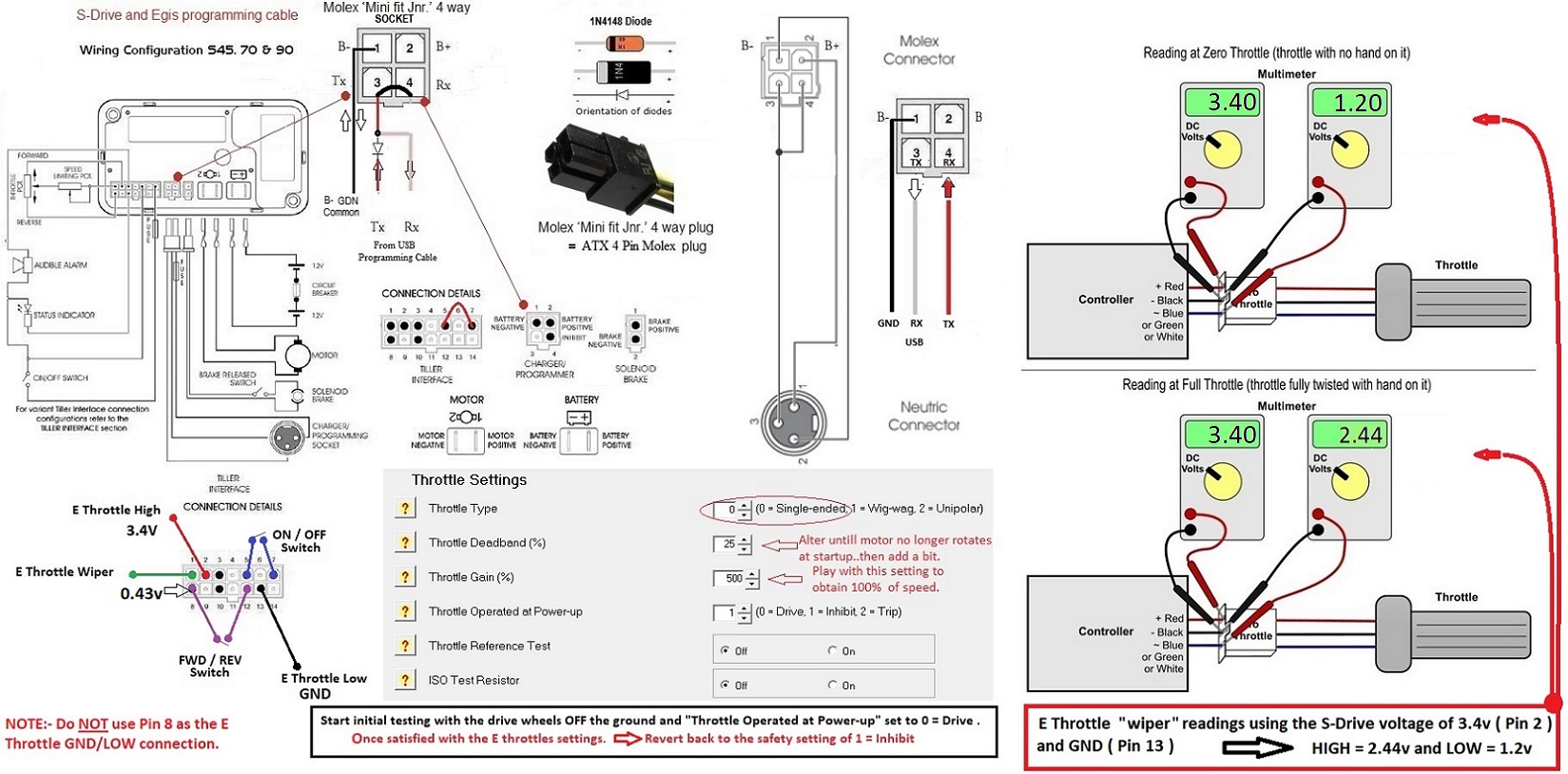

Now I’m working on S-drive from Pg drive technology, dynamic dr90,Curtis 1228.2901
It was free stuff found on old chair for papy.
They all working on 24 volt .
I wanted to make them work with throtle like e-bike 0 to 5 volt .
I found in a manual they need to be programm to accept that change .

Making the S-drive work with an E throttle is possible but requires some faffing about with wiring and programming.
See pic below for how I achieved E throttle control.
