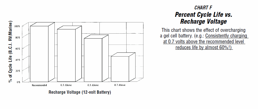

Postby Burgerman » 20 Jun 2024, 21:58
That "24V" that they all show is not the charge voltage. Its a way to describe that it charges a set of 12V lead batteries.
A dead lead battery when your chair shows you a fashing light is around 12.2V each or 24.2V for both when you actually measure it.
The correct CHARGE voltage on an AGM battery is around 14.4 to 14.6V (actually double this for 2 batteries in series so 28.80V to 29.2V) and thats what mosst mobility chargers do. But they are pretty bad at this and they actually wander around, and dont stay at this voltage properly. Then before the battery is properly charged, they stop charging at 14.4 to 14.6V per battery and drop to a lower float voltage that can be 13.3 to 13.8V (it should ideally be 13.6V x2 so 27.2V) indefinitely. At ths point the green ready light is on. But they ARE still charging.
So a gel battery needs a lower voltage, if you are to get the full service ife. That is a MAX of 14.10V per battery. 28.20V and 27.2V float. And almost no mobility charger even get close. So the battery doesent last. They dont anyway if they are too small for the job and yours are. So theres 2 things torturing your batteries.

Re: Hi all :)
Postby Burgerman » 20 Jun 2024, 23:14
Thats the problem.
They dont care. They sell every charger thats cheap and simple with a ad or label that says AGM/GEL but it isnt actually possible. Both are different and have different requirements.
You CAN charge all batteries with the wrong settings, wronge float voltages, wrong CV charge voltage, and undercharge by stopping charge too soon etc and it sort of works.
But it doesent give anything close to the battery service life that you should be able to get.
Let me show you one small graphic from MK who specify 13.8 to a max of 14.1V for their gel battery.
So the perfect voltage (at room temperature) would be 13.85V.
And most charger are for AGM and can be anything up to 14.7V...
