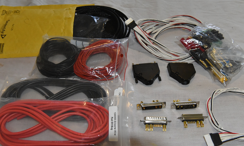

If decent quality. How thick are the wires in a bought cable? You want low resistance and so probably a little thin. The connectors are fine.
I use these, and can have 40A charge on one connector.
And the opposite end on the chair. These allow you to use decent cable quality and only mess around with one connector.
