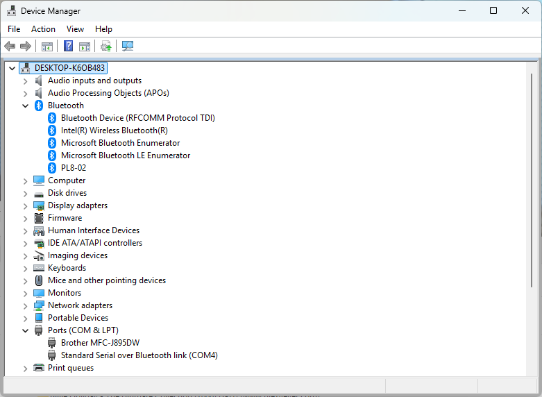

it was on Auto - showed Com 5 open - BUT - in device it shows Com 4 only -
not sure how it opened and works on Com 5 - it dosnt even show it in device manager and dosnt show it in the outgoing ports when BT was paired etc,
very strange - when set to Com 5 direct on the PL 8 - dosnt work - when set to Auto - it works after a long while with Com 5 open - how can this be ?

the problem is - when i pick the correct port that its been assigned - it doesnt connect either -
did you look at the pics above - did you see the ports it shows - Com4 - etc, when the BT was paired
but the PL 8 locks in Com5 - and was working -
when i pick Com 5 direct - it dosnt work - on auto - it picks Com 5 -
