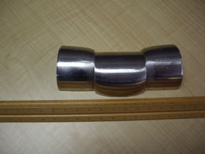

Crap phone video recorded with my crap hands. These are dies for cutting sheet metal. They're machined slightly oversized then "hard turned" as seen here to final dimensions because they slightly warp during hardening. The width and diameter is not critical but they must be nearly perfectly flat and parallel. Hard turning also leaves them very sharp. They can also be resharpened this way several times until you break through the hard surface. These are about rc60 in hardness.
https://www.willsjunk.com/Other/BackupAll/Machining/n-9wQLhh/Images-from-folder-Machining/i-c4wkx4j/A
Finished
https://photos.smugmug.com/Other/Backup ... 326-X2.jpg
