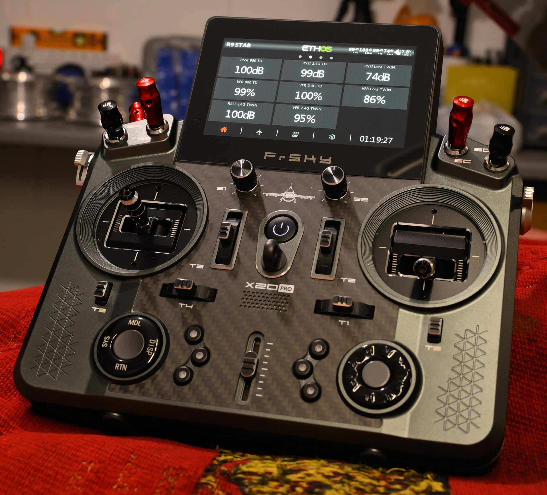

My new FrSKY, X20 Pro AW. As a system its very complex, you need to do a ot of learning. Its mostly great for those with enough brain cels to understand everything and better than everything else out there. But its like giving your sister a turbo, nitrous assisted suzuki when she is 17.
MOST people are overwhelmed by the complexity options, firmware choices and what works with what and why... Not to mention whats legal to do where you live. I never worried about any of that stuff and I like the complexity as it allows me to do what I choose.
Not a choice to be taken lightly. I estimate that 95% of normal RC club members would hate it! And its too complicated for them. But then so is life in most cases!
https://www.wheelchairdriver.com/board/ ... =5&t=12658
40 miles air range?
