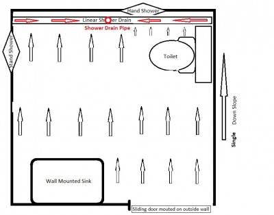

Postby Rye » 25 Mar 2025, 19:59
This is the plan. Single slope, linear drain wet room. At one time it was a tiny bathroom with an enclosed shower and barely enough room to walk in. I had it gutted and now we're removing the concrete and rearranging the toilet drain. I'm trying to keep it open and simple.

Postby Burgerman » 26 Mar 2025, 11:47
Hes making a wet room that drains dow to one end.
