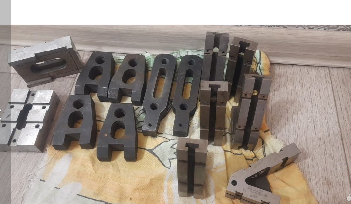

Hi. Tell me, does anyone know what such devices for machine tools are called in America?

In order on your first post:
Fixture plate (T-slot type)
Strap clamps
90 and 45 degree fixture plates (T-slot type)
T slots are typically 5/8" sized on American milling machines. That is the width of the slot the T shaped nut slides into and are threaded for a 1/2-13 bolt. They are available in hundreds of different configurations and different proprietary names from different manufacturers. I use them along with 123 blocks often.
123 blocks are precision ground fixtures that measure 1x2x3 inches. 456 blocks are also common. I don't use them because they're too heavy for me to use easily.

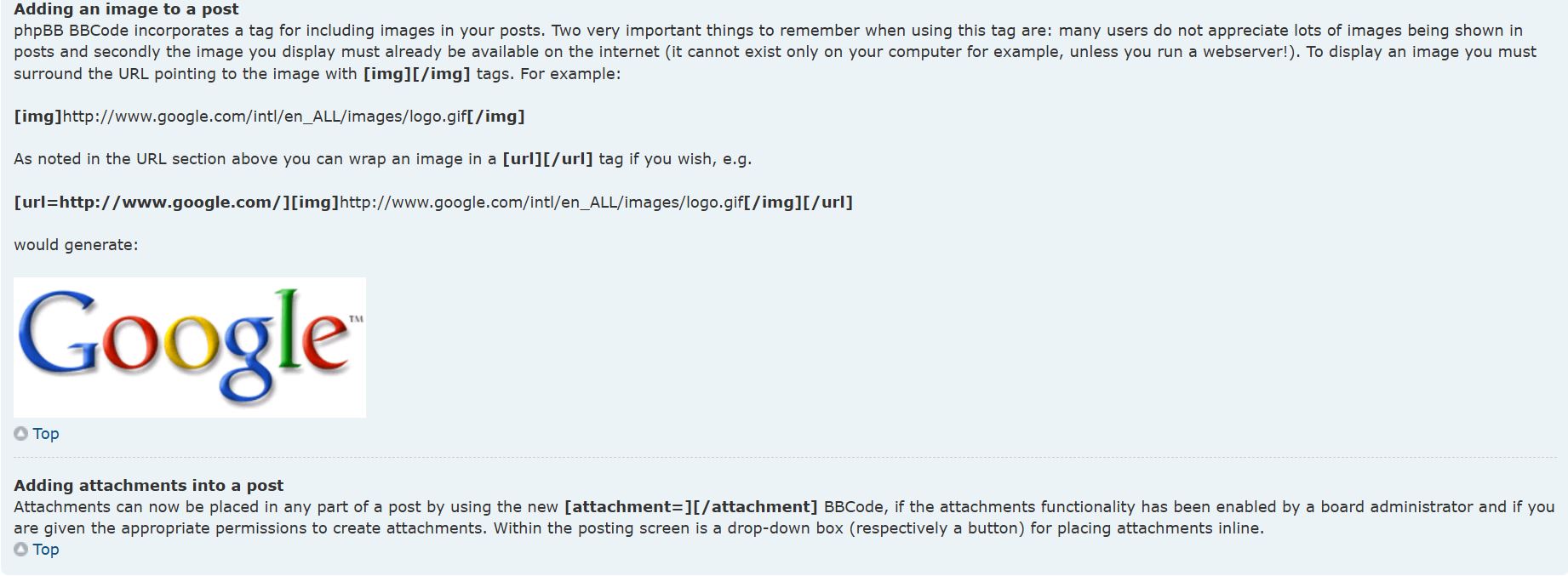

I would post some pictures I have taken of setups I have done but something is broken on the forum or my settings or permissions. I cannot embed photos. I get the attached error. I tried literally copying the example showing how and it gives the same error.

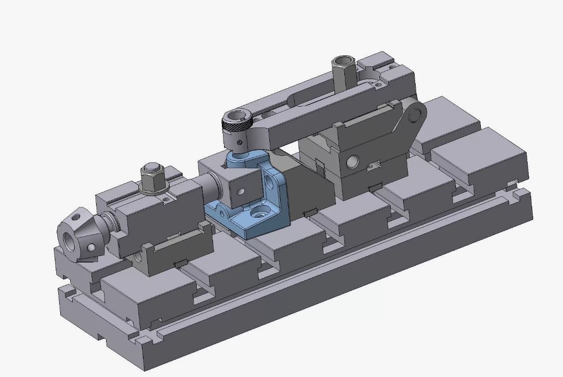

Here's a video of what it looks like. It's convenient for assembling various universal matrices (for welding, drilling, milling).
I wanted to know if such devices are available in the US.

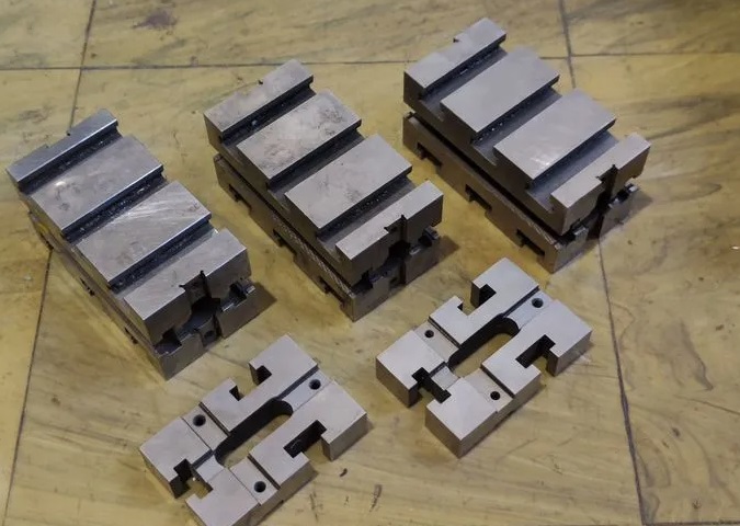

What features differentiate a fixture plate from a "tombstone"? Tombstones as I understand it are rigid base plates that a workpiece is setup on outside of a busy mill. Several tombstones can be swapped into and out of the mill (either manually or automated) to achieve continuous production.
Was wondering if the cross feature on the ends in the first picture might be for repeatably aligning the tombstone onto a mating fixture bolted to the mill table.

Nothing specifically sets them apart, at least that I'm aware of. We typically refer to one as a tombstone on a horizontal mill that multiple fixtures, parts, or setups are mounted to. We don't usually use the same types of setups on a vertical 3 axis mill since you can't easily reach anything but the top.
Nothing says this terminology is correct.

you can turn on subtitles translation. from these blocks you can assemble a jig for drilling. i use it for welding different parts on the table
