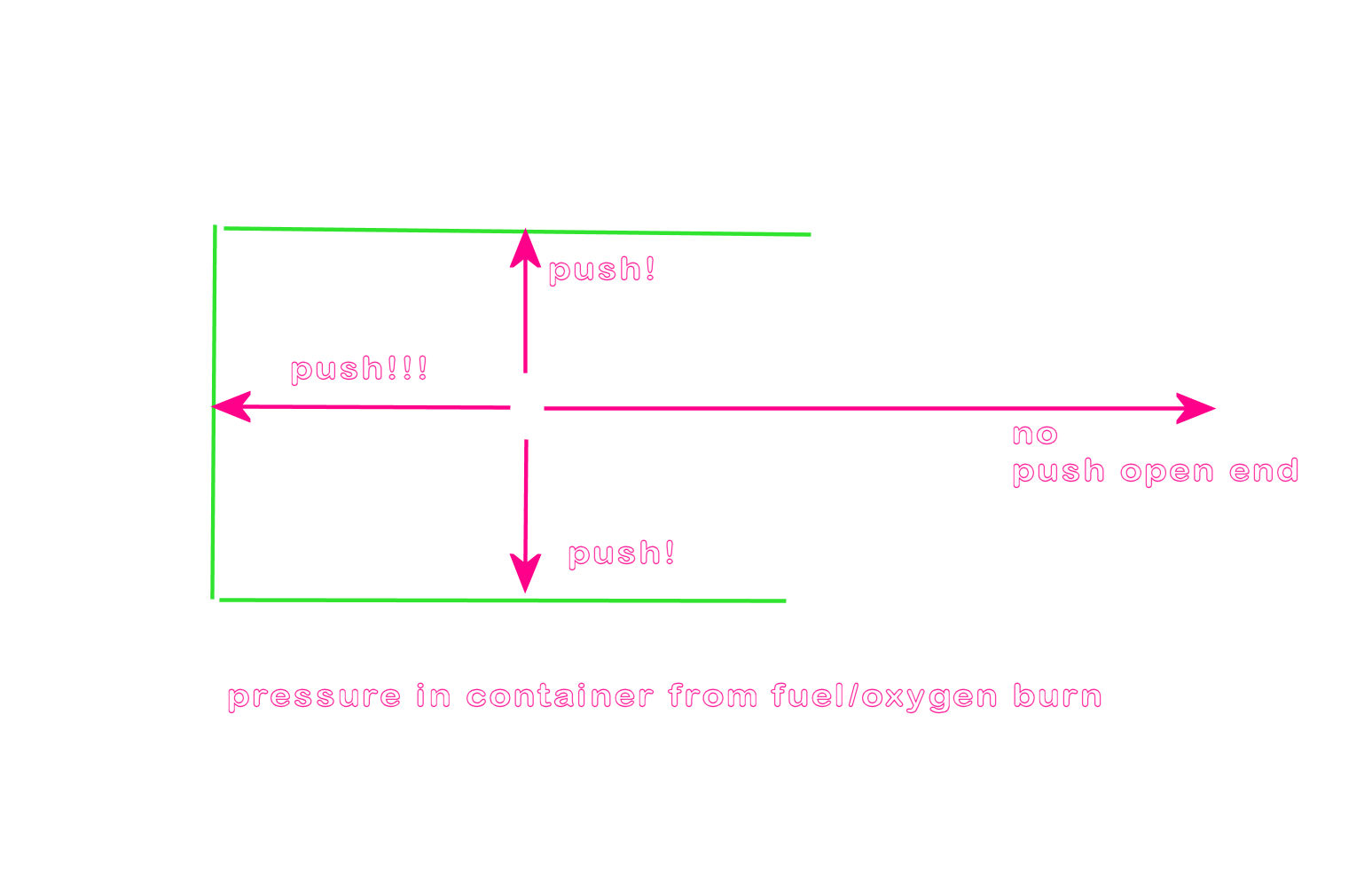

Yes. When you burn the fuel and oxygen, it causes heat. Heat expands the gasses so theres a hell of a lot of them! Those gasses have mass. When you accelerate them to super high speeds thats the "push"...
Where does that thrust actually come from?
OK think about this.
Blow up a balloon. Let go and it flies away at speed. Why? Because inside there is an equal pressure everywhere! It pushes equally on all the inside surfaces. Where the hole is, the nozzle if it was a rocket, that air cant push! But it IS pushing OPPOSITE of that exit hole on the other end of the balloon. The pressure inside the balloon pushes against the far end opposite the hole. Thats why it goes! And why rockets work better in space where no air.
Re: 3 HOURS STARSHIP LAUNCH
Postby Burgerman » 29 Aug 2025, 14:25
I did a crap drawing. Its the pressure on the inside the engine on the face on the left side here that pushes the engine left. Because up/down is balanced... On the right it cant push theres an open end! The gas just escapes! It doesent push against anything.
THAT is how rockets, balloons, even turbojet engines work.
Postby Burgerman » 29 Aug 2025, 14:28
Engine thrust then is:
Pressure inside combustion chamber X Exit nozzle area = thrust.
So: If it has 100PSI inside the engine casing, and the exit nozzle has 2 square inches, then it will make 200lb thrust.
Easy right?
