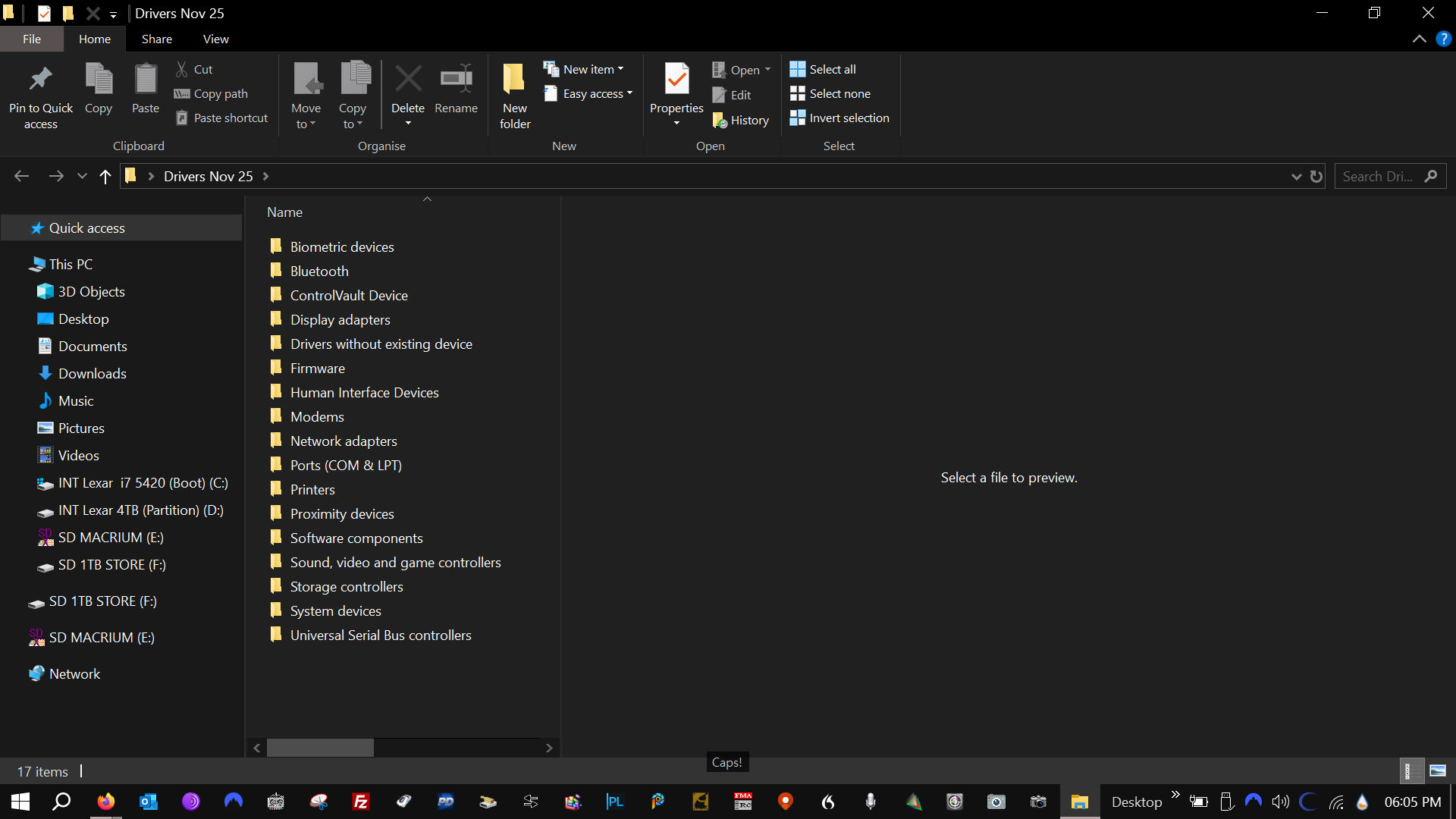

This one allows you to look at all drivers currently on the computer. Delete all the unused or old ones. And as long as everything is all running correctly, it allows you to export all current drivers to a folder. Which you can keep and use in new installations, 10, 11, etc.
Called Rapr
https://www.majorgeeks.com/mg/get/drive ... rer,1.html
What you end up with after selecting/deleting all unused older drivers is a folder. Of about 4.3GB, with every driver in it all itemised. See screenshots.
Customised for YOUR setup or PC as a backup or future use. No more need to use the web...
I use this for driver backups and SDIO all the time.

Postby Burgerman » 17 Nov 2025, 19:27
Anythng gets installed or updated in the future that you want to revert back, or for fresh windows installations, then just install these saved ones from the list. If you do a lot of stability and performance testing this is te only sane way.
For e.g on dell laptops getting sound working proprly and low latency is a fight. Not any more! I saved all the drivers once I found that magic setup!
How?
Point to them from device manager.
Or
Right click the .inf files from an ELEVATED prompt as adminisrator and choose "install"...
Or
Open RAPR and tell it to install them...
Works great. Especially in cases like yours or if you have strange printer drivers or other oddball hobby hardware as I do.
