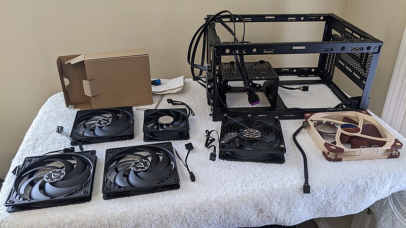

Most of the parts arrived.
Looking at this Noctua cooler.
It's kind of a unique design but I can't see any problem with this style? It should fit.

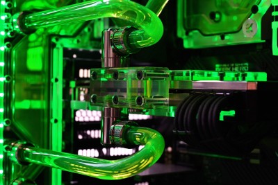

Postby Burgerman » 12 Apr 2023, 09:05

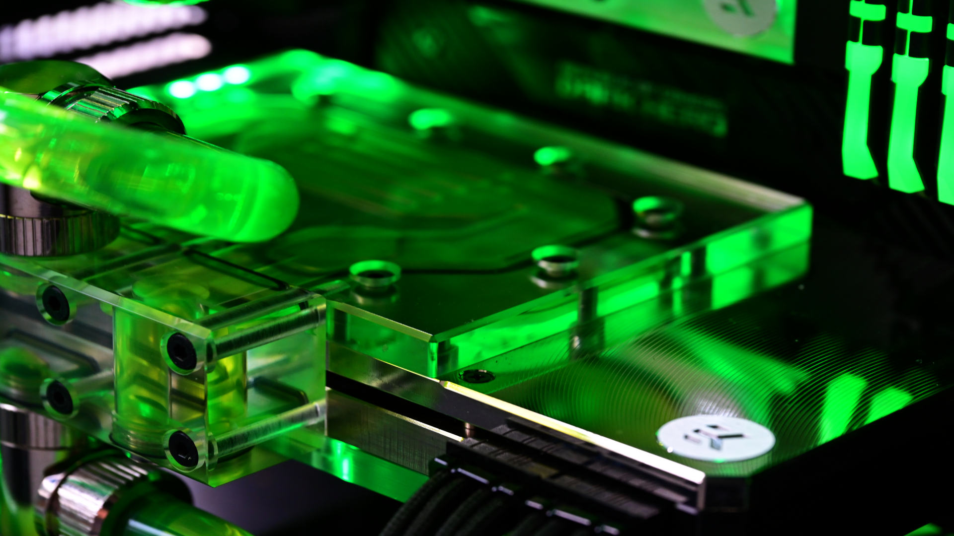

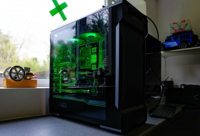

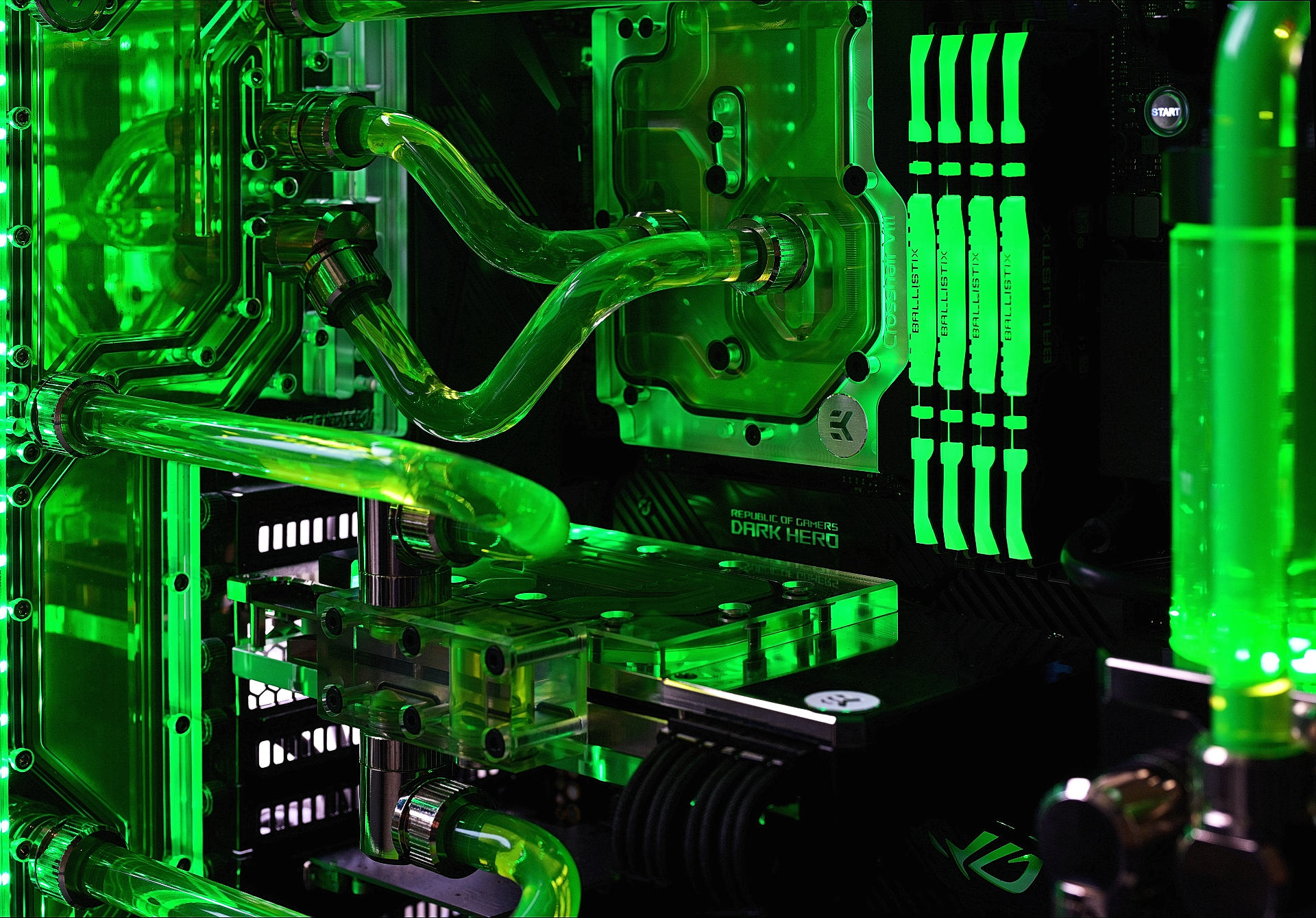

Inspiration. And huge double radiator cooling overkill...
A year and 4 months after building. Used daily. Water is as clean as it was 16 months ago. Who says water is high maintainance. Will change it next year maybe. Not even enough dust to wipe out.
CPU and GPU porn...
Behind smoked glass in daytime. Looks great at night!
GPU and waterblock porn. With liquid metal. Runssuper cool. RTX 3090.
GPU porn 2
CPU and VRM cooler, and GPU porn!
Posts: 71104

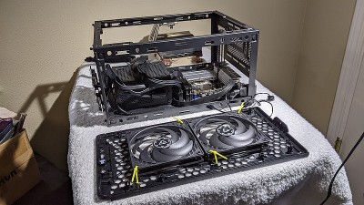

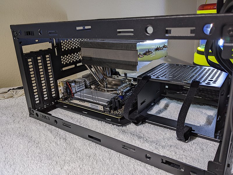

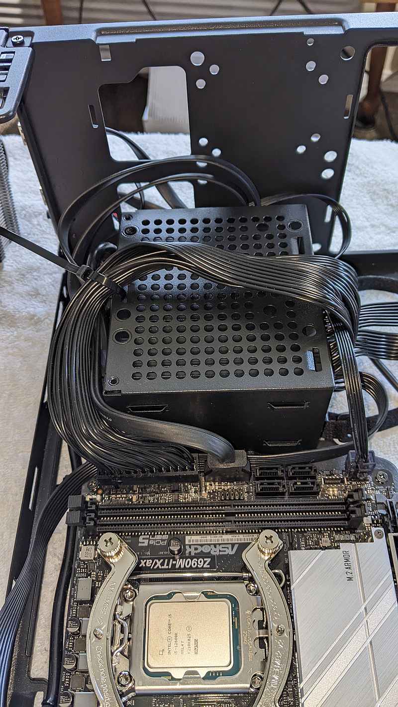

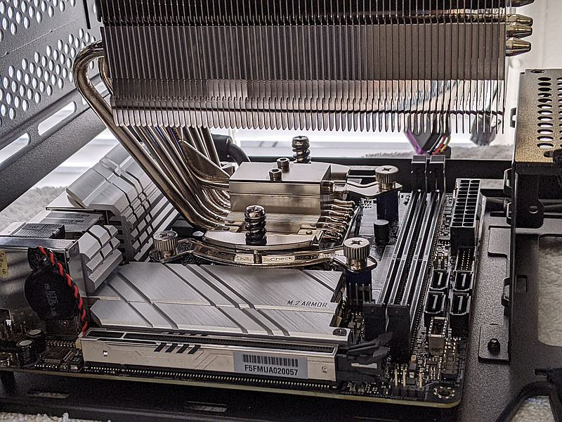

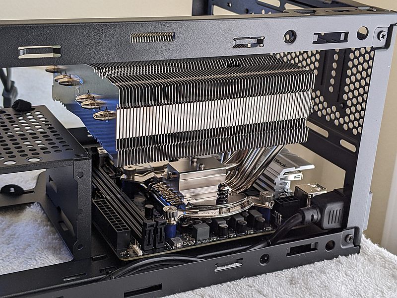

Took about 50 pictures yesterday playing with some different lighting. Not sure what to show. Here are 3 that I like.
The case almost becomes an open frame with the panels removed. Going to need the access to get things plugged in.

Postby Burgerman » 13 Apr 2023, 08:40
That cooler only just goes in there! But it does fit well. Is there room for the fan with clearance? I like the case. You will need good case fans too. Dont worry about overkill / high speed fans etc as they can all be set to ear safe speeds at idle and only ramp up as required.
Mine is silent quite literally, for all normal daily use scenarios. Fans actually stop or rotate slow enough to count RPM by eye. But ramps up fast as water temp sensor sees increases over around a 5 degree change above 35C. And the pump speeds up only with CPU temp and or GPU temp rise. So even the pump turns slowly it idle. Silence is golden. I use a bit of invaluable software that is free for fan control.
You NEED this! Everyone does. Its very advanced and takes some learning and a week to fine tune as you figure out your temps and how it works. But if you value control its way better than th bios or anything else available. https://getfancontrol.com/

Postby Arima » 15 Apr 2023, 20:50
Not sure if the fans will fit but I hope so. Bookmarked the getfancontrol link, thank you for that. Have not figured out exactly which fan to put where. Here is what I have to work with.
Started plugging things together and it got messy. Forgot the I/O shield and still waiting on the second NVMe drive. Suppose I could waste a couple days cleaning the used GPU.

Postby Burgerman » 15 Apr 2023, 23:58
When you finish that theres going to just enough room to hide a joint in it and only if you dont use most of those fans :lol: I admire your optimism!

Postby Arima » 20 Apr 2023, 21:00
The 2 fans that came with the case seemed bulky from the beginning. Hoping the slim fans will do the job. Never seem to be able to think stuff thru far enough in advance. So I tied a couple fans to the lid to get moving on the next thing. Think all my cables are safe from melting or touching the cooler fins. Need to add paste and secure the cooler, plug in the gpu, and it should be ready for the first post.

With my fat digits, and the restriction of parts and fight for space and ports etc I am not sure I would build in anything but a normal sized case. I understand the appeal of small, but its definitely not for me. Custom water is already hard work, and difficult to swap parts as it is.

Postby Burgerman » 21 Apr 2023, 18:43
You might find that an all in one water cooled setup will fit easier. And save space. And the radiators fans are also the case fans.
