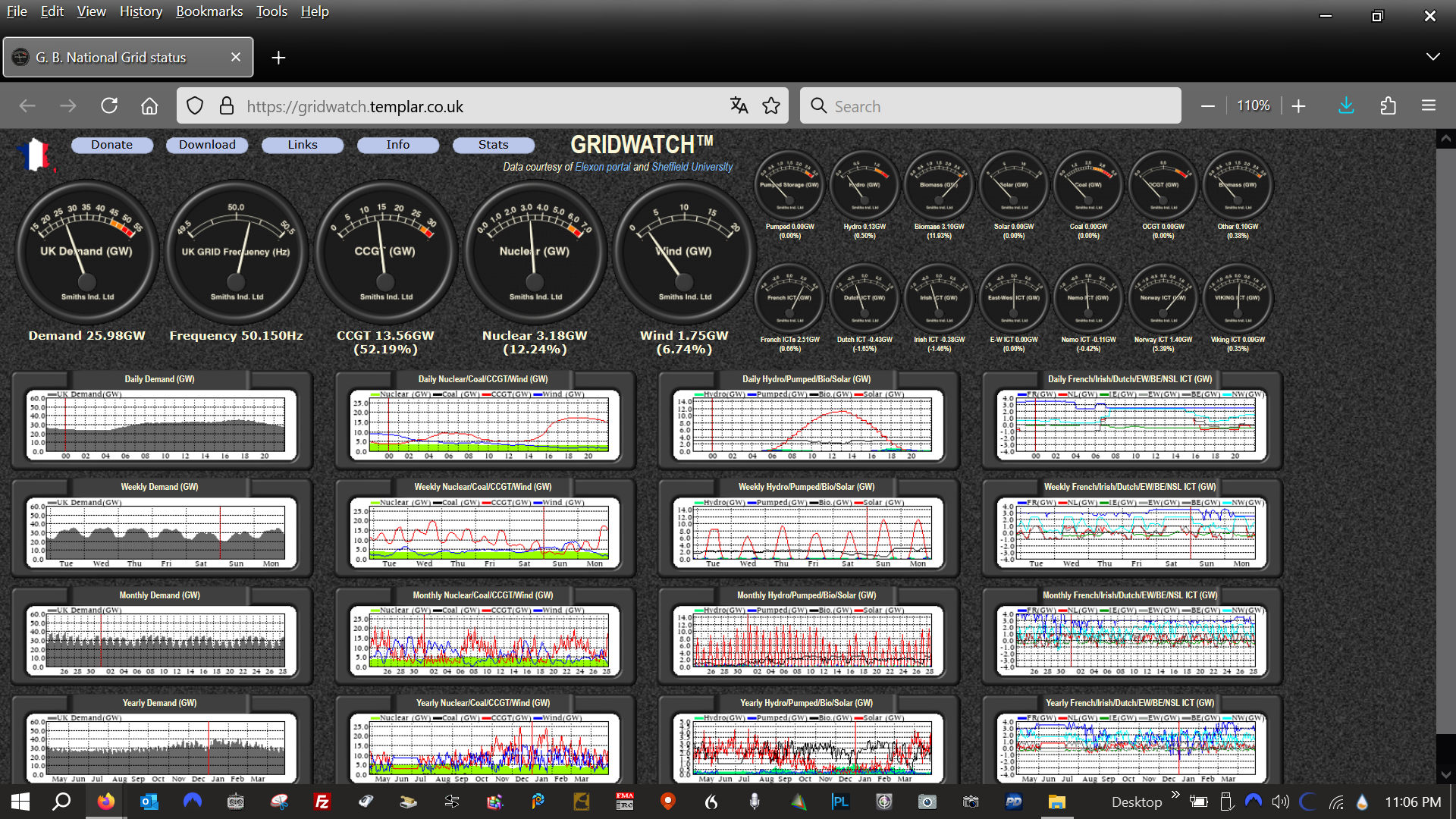

Postby Burgerman » 28 Apr 2025, 23:11
Right now, I can see the folowing...
Look at screenshot!
Demand is very low! Summer, late at night.
And frequency is really high! So the system is generating much more than the consumers are using. So in varous places in the country power stations will be throttling back power or shutting down.
I also see that solar is ZERO...
Wind is just 6% of the total (often its worse!).
And that we are buying power from various countries via interconnects.
