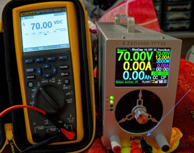

Use an anderson connector. On rear. Or use an XT90 (FRONT).

BLUE ARROW = XT90 CONNECTOR
