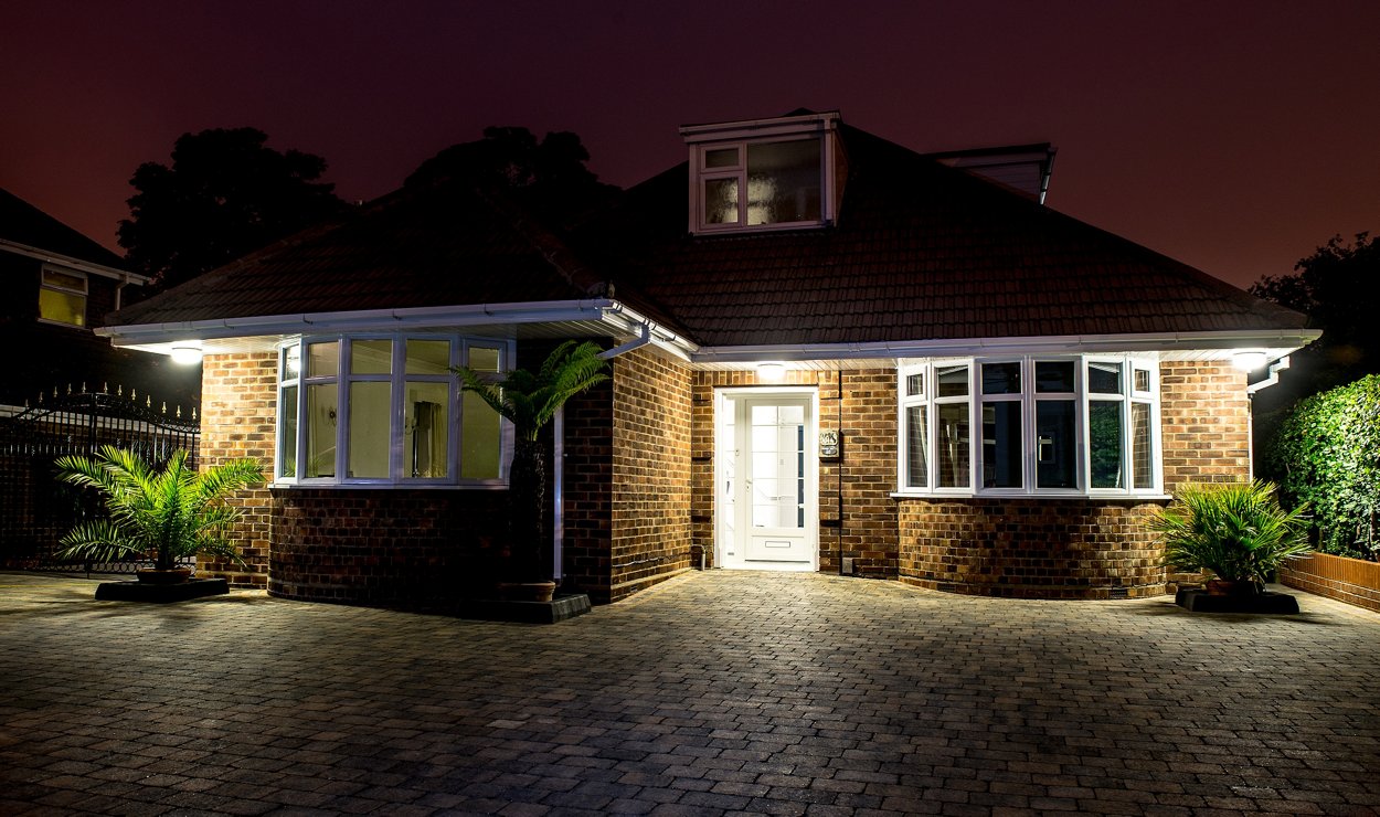

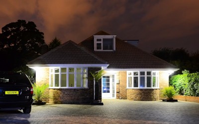

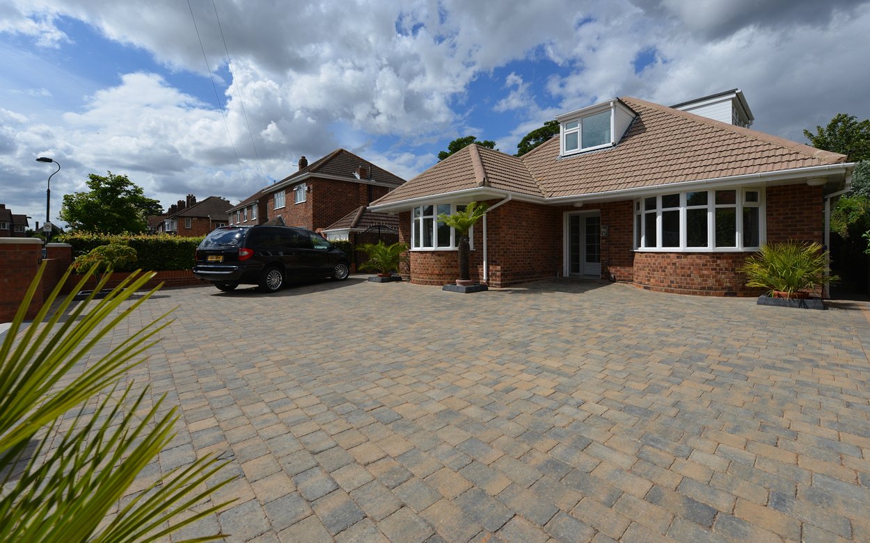

Postby Burgerman » 13 May 2024, 21:16
I agree If its a legal minimum angle as defined by law. But if its your own home you can do it at any angle, choose one that isnt even detectable. Like I did in the pic above. Hell the street - every street, is at more of an angle!
Do you see any ramp? Its blended in, by putting the drive in correctly. There WAS 2 steps. Then a council steep concrete ramp with metal rail. Then there was my mate, a block paver... Who did as instructed.
