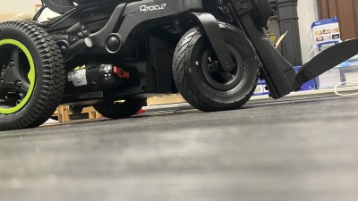

Postby sparkerted » 03 Apr 2026, 22:11
Hi BM,
The clearance is about 15mm from floor to footplate, the dump might be the answer, what was the depth of the spacer please, url would be good, last spacers I bought for the DIetz had a very narrow diameter.
Photo attached.
Obviously the electric centremount foot plate (looks the same as yours) is at that angle to clear the caster wheels. but I note you changed your tyres front and back using original wheels?
Thanks Mark

Postby Burgerman » 04 Apr 2026, 07:21
Can I see a full side on picture?
You seat back (and seat) seems way too far forwards.
Spacers were 8mm bore, short at the rear, longer at the front. Actual length no idea as I just cut them to whatever length was correct at the time by eye.
Rear tyres are on stock rims but have a centre section added. So they are now 3 part rims. To make them a lot wider. And 120/70-8 tyres.
Front rims are stock.
Posts: 71099
