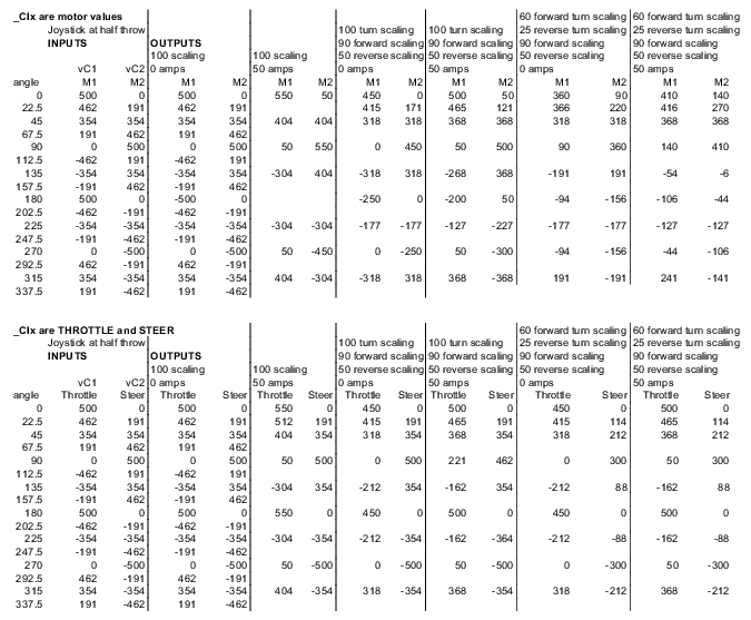

In order to test script 3, I fed the simulator values corresponding to half joystick throw at various points around a circle and recorded the output values with or without speed scaling, turn scaling and motor compensation. I did this with the 3 GoSubs that assume that the _CIx values read by the program are M1 and M2 (post mixing), and then I did it all again with the other GoSubs that assume that the inputs are THROTTLE and STEER (pre mixing) active.
In the first case (M2/M2) all scaling should affect both motors: speed scaling in the same sense for both, turn scaling in opposite directions for the two motors. Compensation gets independently applied to each motor.
If the inputs are THROTTLE and STEER, speed scaling only affects THROTTLE and turn scaling only affects STEER. To do compensation, the THROTTLE and STEER values are mixed to get M1 and M2 values, compensation is done on those, and then they are un-mixed to get back to the compensated THROTTLE and STEER.
Here's a table of the results. The input values are the cartesion coordinates of the joystick positions. I've hidden the columns that do the trigonometry for this, but if people want the actual spreadsheet I can provide that; both as the original QuattroPro and as an Excel export. I am more a numbers than visual type, but maybe Woody will come up with a way to graph these for those who think visually.
script 3 testing.jpg (153.76 KiB) Viewed 21969 times
I think that all of these numbers make sense, but would certainly welcome other checking them too.

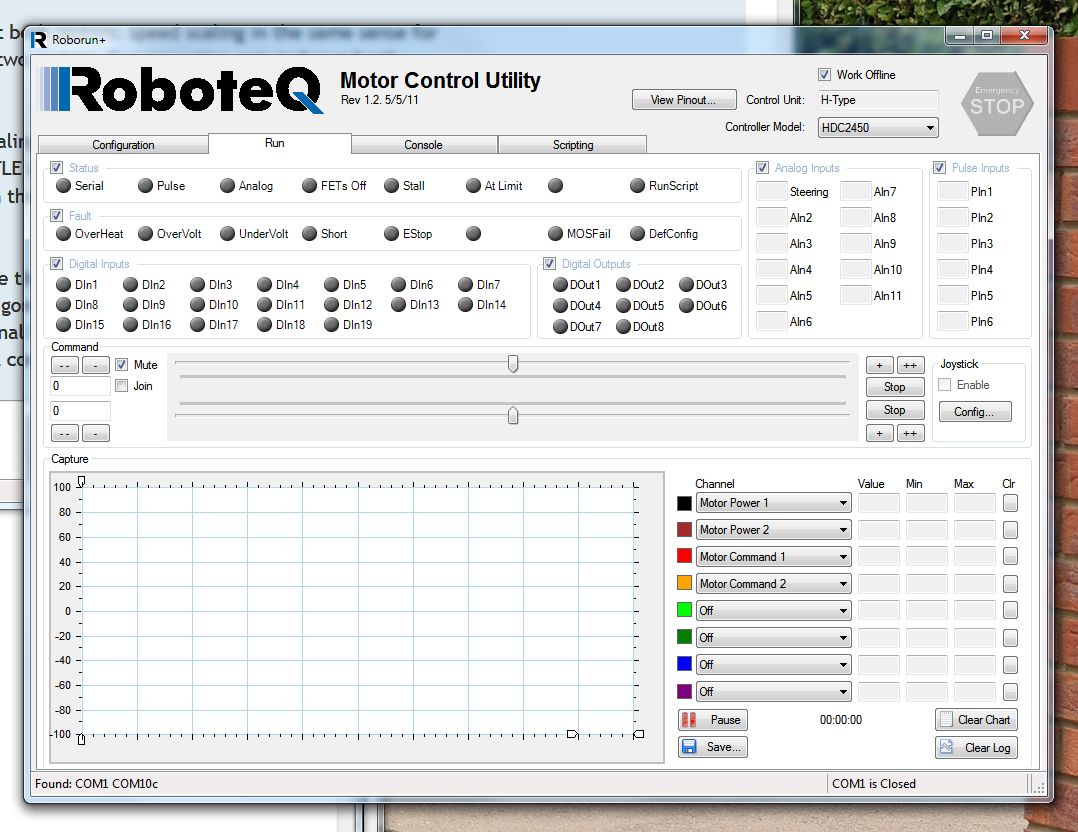

>>> Woody, if there is a mute button that appears only when a joystick is connected, it should definitely be pressed while the script is running in the controller. Pulse and Serial information are not completely hardware independent in the Roboteq and there will be conflicts. Maybe, unlike Work Offline, mute lets you still receive serial (so that you can monitor what's going on) and just blocks sending. Ciao, Lenny
The mute button is a tick box on the run screen. Its always present. If the tick is removed the box, ONLY serial data control is available. If it is ticked, it runs according to priority. So changes to pulse.
Analog input levels are zero as this is set to "no action" rather than a motor. The RC pulse input works great. And very accurate consistent and precise, as soot as you tick "mute"... And trust me, I am running this script on the roboteq after downloading to device. By manually starting the script, then ticking the mute box.
Only inputs enabled are pulse and serial.
ADDED. Mute button always exists if you have selected a controller. EG work offline, choose hdc2450

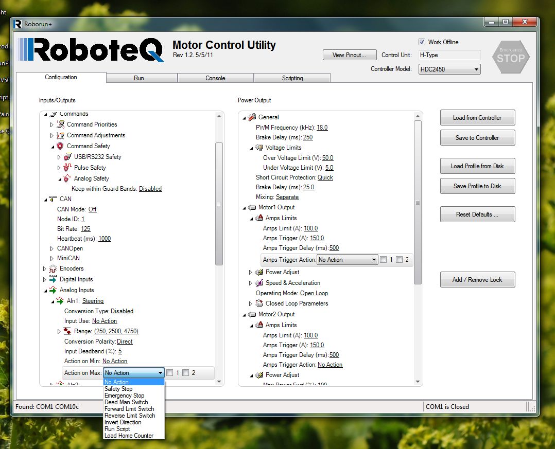

Postby Burgerman » 09 Sep 2012, 16:07
On the screen below, tick off line box. Choose HDC2450. Now on all my PCs, inc the laptop, I see the same thing as below. Roboteq, and any joystick, definitely not connected!
Note tick box marked mute? And all analog, pulse inputs say 99999 unless the ticks are removed and then put back. Then empty. As shown. But they dont have any affect anyway. At least when DISABLED (no action) in roboteq software. When RC RX connected it reads 1500 (centred) give or take 1 either way.
Postby Burgerman » 09 Sep 2012, 16:12
When the program os opened and connected, the mute makes it behave normally. Otherwise the software takes over command via serial. Can be via those sliders, a windows PC joystick, etc.
Mute normally prevents the serial command data being "in charge" and the roboteq then uses the order you choose to decide which input to use. Poled every 1 second. In my case RC gets priority, since I can then switch on and drive my chair about and the analog joystick gets ignored. Switch off and the analog joystick takes over.
