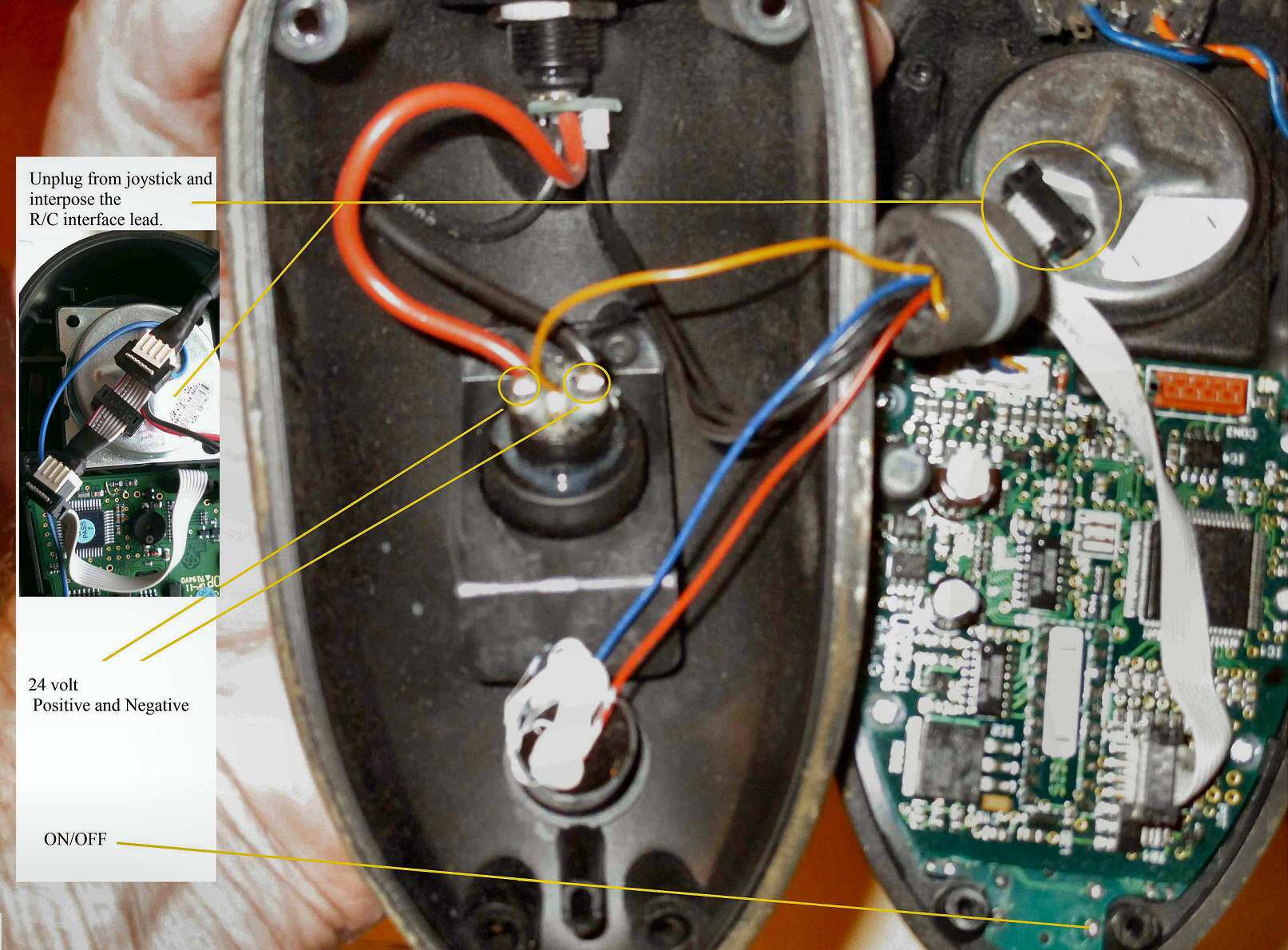

Postby woodygb » 09 Dec 2014, 08:58
Please note that there are TWO versions of the OMNI ..one is suitable for a Pilot+ control system.... the other for the R-net control system.
This is a pic of the insides of a Pilot+

Will my 6 channel tx be enough for the 4 actuators and chair?
Your 4 actuators are controlled how ... pod button press ( 2 buttons ) and joystick ?
If so you need just 1 channel for the 2 button presses as the R/C transmitter joystick is effectively the equiv of the pods joystick and this can be done with the Arduino.
