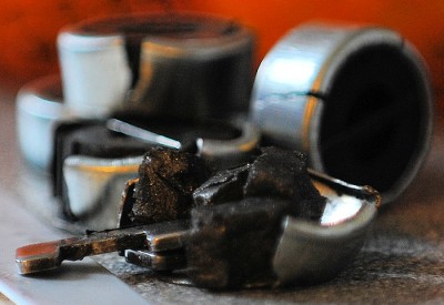

They do this:
Heres about 6 destroyed ones!!!

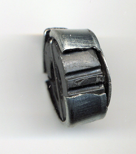

Heres one that hasnt totally disintegrated YET...

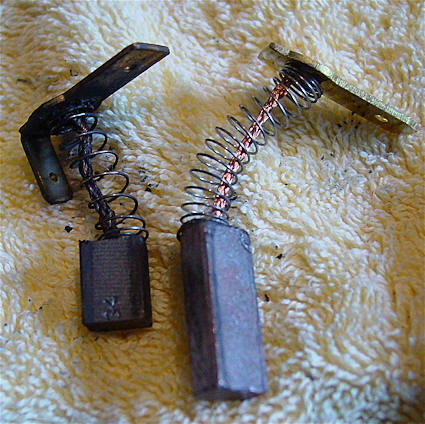

By the time they get to this stage the brushes are usually knackered too...
But in reality so is the gearbox, magnetic strength, bearings, commutator, brake etc. They all wear out together so a replacement unit makes more sense.
About to disintegrate
One good. One knackered

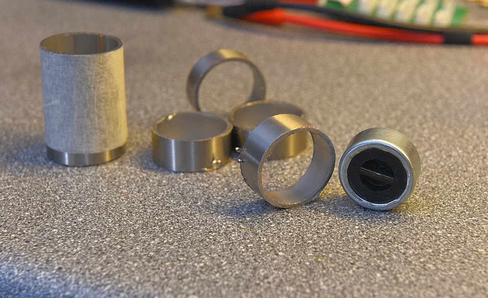

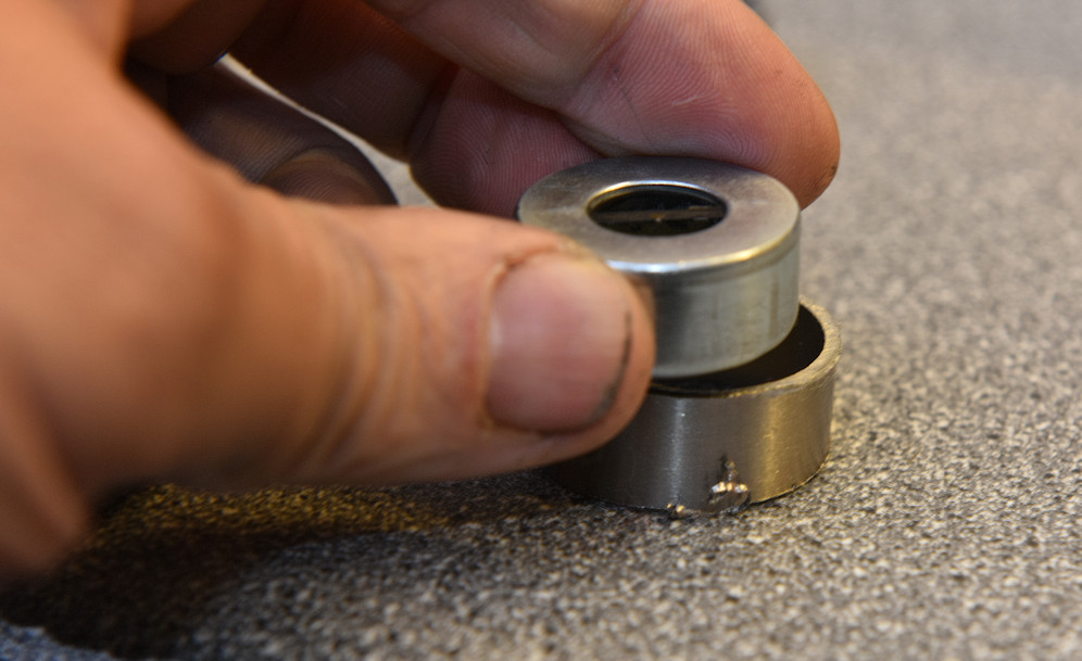

By sleeving it in a stainless steel RING. A slice of exhaust tubing...
Re: Yearly Motor Failure
Postby Burgerman » 24 Mar 2025, 22:17

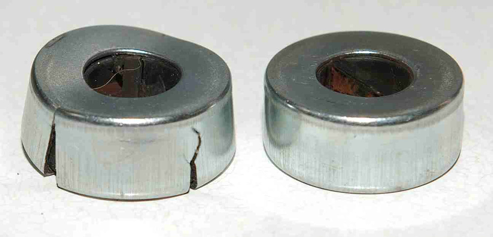

Heres a slightly split one... No good. And a healthy one! As you add torqu to the motor, the rubber tries to expand. It splits the steel case outwards.
Heres some steel tube. And a NEW cush drive rubber.

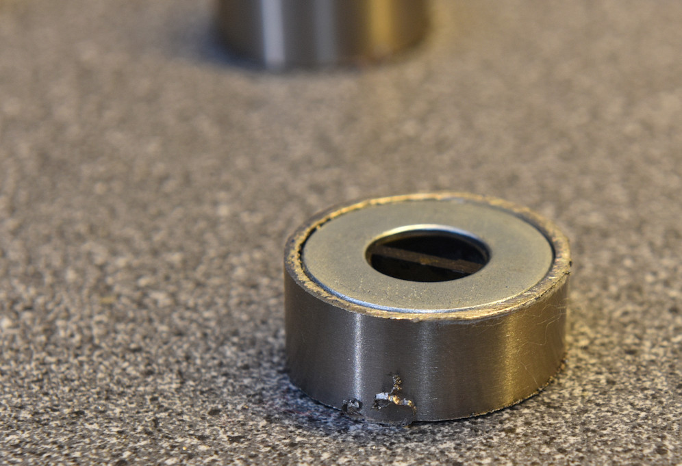

Press and loctite one inside the other! I used a vice.
Then it looks like this. Uneven... File off the uneven edges. And then refit. Now it will never fail ever again. But something will!
