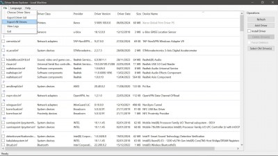

LROBBINS wrote:I've downloaded RAPR and will give it a try-
What happened?
Re: Dynamic Wizard 5 vs. Windows 11
Postby LROBBINS » 02 Apr 2025, 22:45
Not much. I did download RAPR and created the listing of all of the drivers in the Win11 machine's driver store, hoping that there would be a tool to mass import them after installing Win10-LTSC iOT from an image of the slightly older HP X360Spectre (which also came with Win 11, but on which I had no trouble installing 10 LTSC). I could not find any such too so I decided to get a RAPR-generated listing of what drivers are present in the LTSC install. Surprise: on this machine RAPR could not even enumerate the drivers - just sat there doing nothing. I haven't had the time to try to play with it further.
I still suspect that the invisible devices problem is not a driver issue, but a difference between an 18 month old Intel I7 processor and a 6 month old Intel I7 that is very different, and the fact that RAPR couldn't even write a log of the driver store on the machine with the newer processor, even under Win10 LTSC rather reinforces that.
I suspect that I will have to bite the bullet and install Win11-LTSC even though that means having to reinstall all of my software from scratch. How I'll ever find the time to do that, I haven't a clue.

Postby Burgerman » 03 Apr 2025, 08:13
Is this a full version of the program? I dont remember if mine is cracked/full or if its free...
Never mind, free...
I dont get it.
Is it because of all that new security nonsense? Because I just disable all that in bios and in 11. And 10. LTSC doesent need it.
I see and can import or export single or all drivers in the program on every machine ever tried. Older version. But not much.
Thi is what you should see. I delete all the ones marked as OLD. That leaves 233 drivers. I export these to a folder. It has named sub foldrs with 233 drivers inside. Abous 3GB total. I reinstall as needed. From device manager or from inside rapr or by right clicking the inf file and choosing install.
