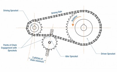

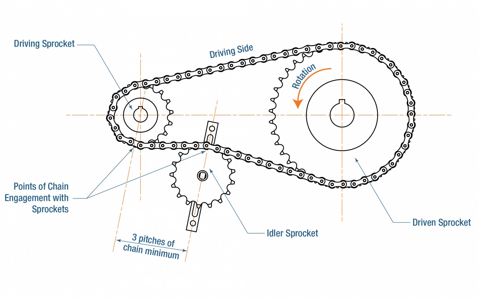

I just went from 23t to 19t. Didn't need to touch the chain. Tensioner has actually A LOT of play.
Not sure what you mean by play.
A chain should run between sprockets as straight as possible, without getting excessively re routed by a tensioner. Because that just loads up the tensioner hard when that run of chair is pulled tight. Causes friction and less efficiency and possibly moves it if the spring tension isnt adequate.
The less it deflects the chain the better.

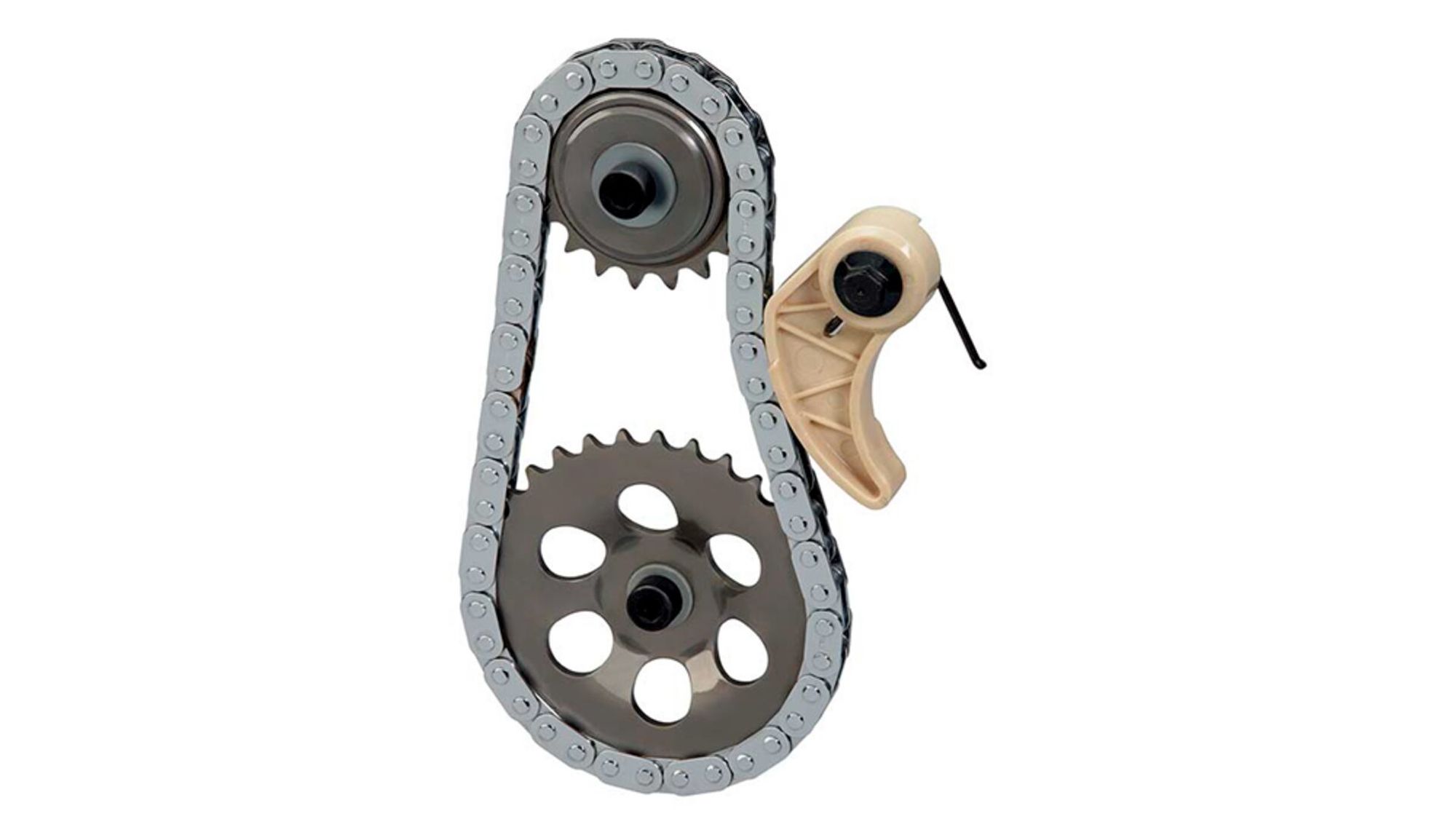

I just looked at a parts list.
Bounders do not have a chain tensioner. Those are designed to take the slack out of a chain run and are spring tensioned. Used on bikes, inside engines etc on motocrossers drive chairs etc so as the chain wears the tensioner takes up the slack to keep the chair from making noise, thrashing around etc. It keeps it "tight" automatically.
The bounder has a chain adjuster like a motorcycle or bicycle chain and a quick release cam. When the motor or brake is square with the frame, with the chairn tensioned so that theres about 5 to 10mm of movement in it, then the chain is correctly tensioned. Since no oil pressure or spring tensioner you will need to adjust it manually as it wears. Since you already took up 3 or 4 full links of tension adjustment then its likely that the motor is no longer parallel with the frame and you will run out of adjustment as the chair wears.
