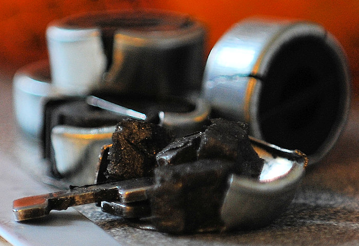

Postby Burgerman » 11 Oct 2025, 02:46
In all chairs, between the motor, and the gearbox there is a rubber coupling. Designed to remove that ultra low speed notchy feel. When new they are hard. When old they are soft (and disintegrate...)
In between times they make things smoother.
But again this depends on your definition. You can only feel this at 0.01mph. About 1/2 an inch per second. Any faster, like actually moving anywhere and it vanishes. It a tiny affect and really shouldnt bother anyone. The fact that I can feel it on a new chair is of absolutely zero significance to me? I cant say I ever notice in use. Only if looking for it. But my chairs are all programmed to go. I dont move about at those speeds. It exists but, who cares?
Why does it bother you?
These, are some that I disintegrated earlier in true blue peter fashion!
https://www.wheelchairdriver.com/powerchair-fault.htm
And one or two very failed ones...
That black stuff is what used to be rubber...
"Its dead Jim"

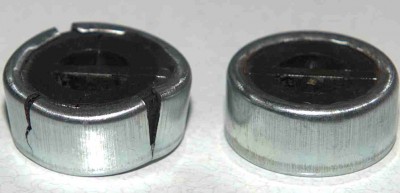

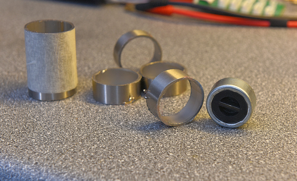

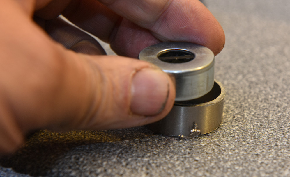

Postby Burgerman » 11 Oct 2025, 02:54
Heres how they SHOULD look. And some that are failing...
When you load up the motor hard they fail. Especially if your chair is programmed to GO like mine all are. And if you drive it like you stole it. Then, these things fail on every chair I had them fail on 2 and 4 pole motors, EMD linix, and AMT.
The rubber twists, expands outwards and breaks the external steel case. And then you go nowhere!
This takes me about a week.
To prevent this from ever happening, then BEFORE you break them while the chair is new, cut some steel or stainless steel tube, that is a tight fit externally over the top. Press this together in a vice with some loctite. Then file and trim up neatly. (not shown here)
Now. DO these BEFORE they fail as in most cases you cant find new ones... And in any case you dont want to get stranded far from home.
A picture is worth a 1000 words...
On the right a new healthy new one.
Again on the right a new one!
BEFORE they fail, cut some tight fitting stainless steel tube.
Press these together in a vice so that the rubber cant expand and break the thin steel casing...
Then it looks like this. Ready to be filed and trimmed up neatly. Now they dont ever fail!
