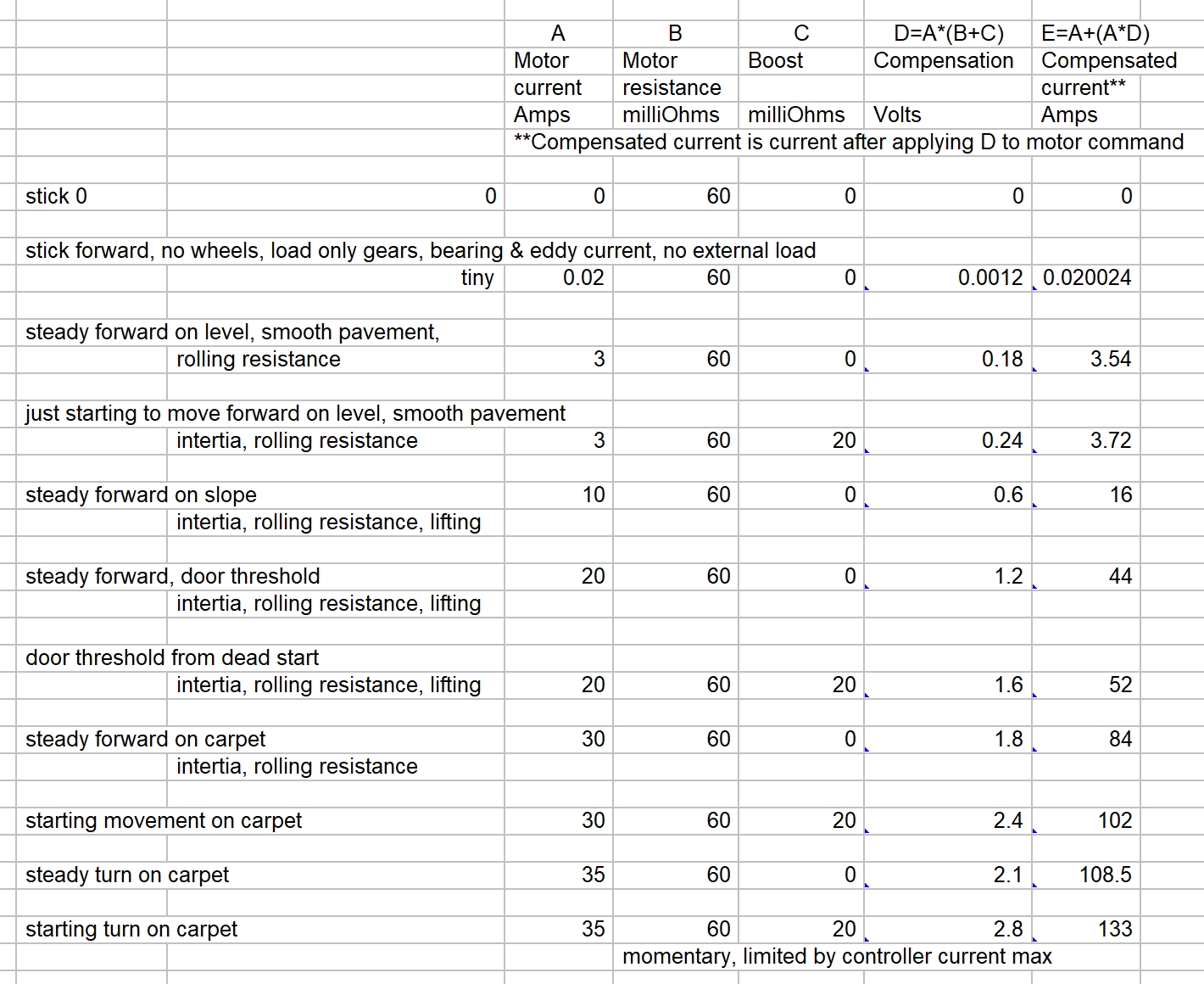

Postby LROBBINS » 21 Sep 2025, 11:58
Vitolds,
I have been reading everyone's post and didn't plan to respond until Tuesday evening or Wednesday when I'll have more free time, but the last coding change you posted is not only wrong BUT EXTREMELY DANGEROUS!
In MotorCompensation: the original script has:
Code: Select all
  M1Comp = (ILeft*(MotorResistance+CompTurnBoost*ExtraComp))/BattVolts
and you changed this, just moving a (, to:
Code: Select all
  M1Comp = (ILeft*(MotorResistance+(CompTurnBoost)*ExtraComp))/BattVolts
IR motor compensation is current*impedance In it's basic implementation this is just:
Code: Select all
M1Comp = ILeft*(MotorResistance)/BattVolts
But, impedance is not constant. It is lower when the motors just start to move, and higher after the chair is moving along. This because the frequency of motor pulses (PWM for brushed, commutation frequency for brushless) is lower at low speed, and higher as speed increases. To adjust for this we want to increase the calculation of impedance by some amount (that's ExtraComp) when starting movement with that addition going away as speed increases (ComTurnBoost goes from 100% to 0 as speed increases). Adjusting the value of ExtraComp is the last thing we do when tuning the chair, so for now CompTurnBoost = 0 in user settings.
First, what happens to M1Comp with the original code.
Code: Select all
'Before tuning and just starting movement, MotorResistance = 50 CompTurnBoost =100% and ExtraComp = 0
impedance = (50+1*0) = 50 milliOhms
'and when chair is moving
impedance = (50+0*0) = 50 milliOhms
so we have just basic motor compensation at all speeds.
Now, let's see what this does once we've tuned CompTurnBoost to a value of, for example, 20:
Code: Select all
'starting movement -
impedance = (50+1*20) = 70 milliOhms
-- impedance boosted from 50 to 70
'and when already moving -
impedance = (50+0*20) = 50 -- back to basic compensation when already moving[/code]
This is the way MotorCompensation should work!
Now, what will happen in your modified code with the ( moved?
Code: Select all
'Before tuning and just starting movement with MotorResistance = 50, CompTurnBoost = 0 and ExtraComp = 0
impedance = (50+(1))*0 = 0 milliOhms
impedance = (50+(0))*0 = 0 milliOhms
so we have NO motor compensation at any speed.
Now, let's see what this does if we change ExtraComp to a tiny value of, for example, 1:
Code: Select all
impedance = (50+(1))*1) = 51 milliOhms  '-- impedance slightly boosted from 50 to 51
'when already moving -
impedance = (50+(0))*1) = 50 '-- boost of MotorCompensation disappears when already moving< correct behavior
But now, what happens when CompTurnBoost is tuned to a reasonable value of 20:
Code: Select all
impedance = (50+(1))*20) = 1020 milliOhms '-- RUNAWAY!
impedance = (50+(0))*20) = 1000 '-- RUNAWAY!
YOU ARE RISKING YOUR SAFETY if you do this. And, if you do this in closed loop speed, you may not hurt yourself because the current will exceed the maximum allowed, but you will overheat the motors and controller and might even damage the controller.

Postby LROBBINS » 24 Sep 2025, 13:35
Vitolds,
I do not appreciate the ill-tempered, ill-informed, almost entirely incorrect diatribe in your last posting. At first I was tempted to correct what you've written sentence by sentence, but then I wondered whether I should just not respond ata ll. Finally, I have decided to respond only to your statements about MotortCompensation.
You said that:
motor compensation is assistance (amplification) for turning the chair in place and that the motor compensation program itself is correct, but its implementation is flawed. But in fact, motor compensation is always the addition of readings to the joystick, EVEN WHEN IT IS NOT NEEDED.
MotorCompensation is not there for turning in place. MotorCompensation is there to give near constant speed with changing load. It is a classic method used for DC motors for more than 50 years. For turning in placeis CompTurnBoost is added.. The only difference between my script and what is done in an Rnet controller is that I call the user setting for this CompTurnBoost and PG calls it Torque. Given CompTurnBoost = 0 in the starting user settings, and only gets added during final tuning of the chair's parameters, turn-in-place is, for now, TOTALLY IRRELEVANT.
John (Burgerman) has alread replied, in a very abbreviated way, to the assertion that my script is adding reading to the joystick even when it is not needed. He wrote:
It doesent.
It literally does nothing.
It responds in direct proportion to load.
He is absolutely correct. The MotorCompensation: subroutine is called all the time, but the result of its calculations is not "always the addition of readings to the joystick". As you once said "it's only math", so here's a spreadsheet in which I've put some numbers and done the math to show the result of MotorCompensation: in a variety of situations

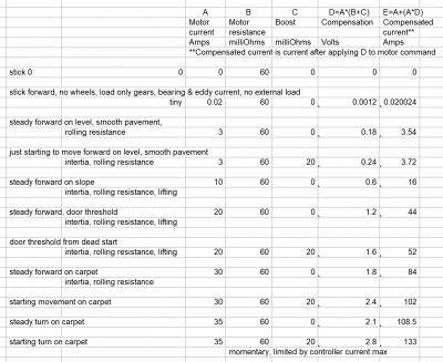

Re: PINNED - Roboteq Controller - developing for powerchairs
Postby LROBBINS » 24 Sep 2025, 14:09
Sorry, I hit Send when I meant to hit Preview. Here's the full message:
Vitolds,
I do not appreciate the ill-tempered, ill-informed, almost entirely incorrect diatribe in your last posting. At first I was tempted to correct what you've written sentence by sentence, but then I wondered whether I should just not respond at all. Finally, I have decided to respond only to your statements about MotortCompensation.
You said that:
MotorCompensation is not there for turning in place. MotorCompensation is there to give near constant speed with changing load. It is a classic method used for DC motors for more than 50 years. For turning in place CompTurnBoost was added. The only difference between my script and what is done in an Rnet controller is that I called the user setting for this CompTurnBoost and PG calls it Torque. Given CompTurnBoost = 0 in the starting user settings, and will be 0 until you change it during final tuning of the chair's parameters, turn-in-place is, for now, TOTALLY IRRELEVANT.
You have repeatedly said that MotorCompensation makes your motors misbehave. I believe you. You first said this when you were trying to make closed-loop speed control work. In open loop you still say that MotorCompensation is causing motor action when it shouldn't. However, you have never done the one thing that would help us figure out why. You have never tested and graphed this with the complete script that works for Burgerman's heavy chairs with brushed motors and high voltage batteries, for Will's chair with brushless (Hall effct sensor) motors, and in Rachi's lightweight, all aluminum, chair with brushed motors and 24V batteries (or the "standard" chair she had before this one). You have always changed the script before doing your tests.
John (Burgerman) has already replied, in a very abbreviated way, to the assertion that my script is adding readings to the joystick even when it is not needed. He wrote:
It doesent.
With stick = 0 , "It literally does nothing."
With stick forward, but no external load, it does almost nothing.
In all situations, "It responds in direct proportion to load."
I have a suspicion of why your motors behave differently with and without MotorCompensation even when they shouldn't. But there's no use tryhing to deal with that until you test the script properly and show me, with graphs as well, what happens with and without MotorCompensation. (BTW, you don't have to change or comment out any code to get rid of MotorCompensation -- just set MotorResistance = 0 in user settings.)
If you now understand what Motor Compensation is and how it works, and are willing to do what I suggest, I am willing to continue trying to help. For example, I could show you how to navigate in the complete, long script, jumping right to the things you want to look at and ignoring, instead of removing, the parts that are irrelevant for your particular chair. Very little scrolling up and down, and doing this you wouldn't risk making changes that might mess up how it works. But writing that up precisely, with examples, carefully formatted, proofread and edited would be hours of work. If, however, you have decided, as your last message implies, that I am an idiot who doesn't understand wheelchairs and doesn't know what he's doing, BYE BYE.

Because even a free running motor has SOME current - maybe 5A.
Thats correct. If its configured CORRECTLY it will add a small amount of additional torque (CURRENT) needed to run a motor. Its proportional. The whole point of it is to make the motor produce the same level of TORQUE not speed, regardlesss of load. Now just load ONE motor and it will continue to turn at the same speed as the other one.
So it responds to aceleration as well as deceleration. In deceleration it adds extra redardation as thats a negative load. It makes the chair respond at a predictable speed that is controlled by the joystick position and corrects this so that load (be that turning, ramp, hill, acceleration etc) does not change the speed.

John, I know this theory.
But in practice, things aren't quite like that.
This only applies to this script and this controller.
I AGREE that this is how it should work!!!! But in the script, everything is wrong!
Find the error.

Postby Burgerman » 24 Sep 2025, 16:54
Works ABSOLUTELY as expected here. So pretty hard to find any error!
But I have not messed about with stuff I didnt usnderstand. I did thousands of hours of testings and helping lenny write that script long before you came along.
I even built this bot to safely test skid steer and to help develop that script. And as you can see it performs perfectly here. If I drive at 10% speed, and turn, then the speed stays exactly the same, even though it requires 10x as much current than it did to drive straight. Compensation performs perfectly. Turns, forwards, up a very steep ramp, braking, all exactly as it should.
It drives and steers EXACTLY the same, same stick feel, same control, regardless grass, loose gravel, carpets, wet, dry concrete or tarmac. Superb fine easy control.
Load or "power" required jumps up and down by 10x or more, as the compensation works in the background, while speed stays EXACTLY the same, at the same stick position. It just does as it is supposed to do. Requires zero stick skills.
Watch this very carefully. Its a small roboteq with the same script.
https://www.wheelchairdriver.com/gopro/bot.mp4
Comments?
