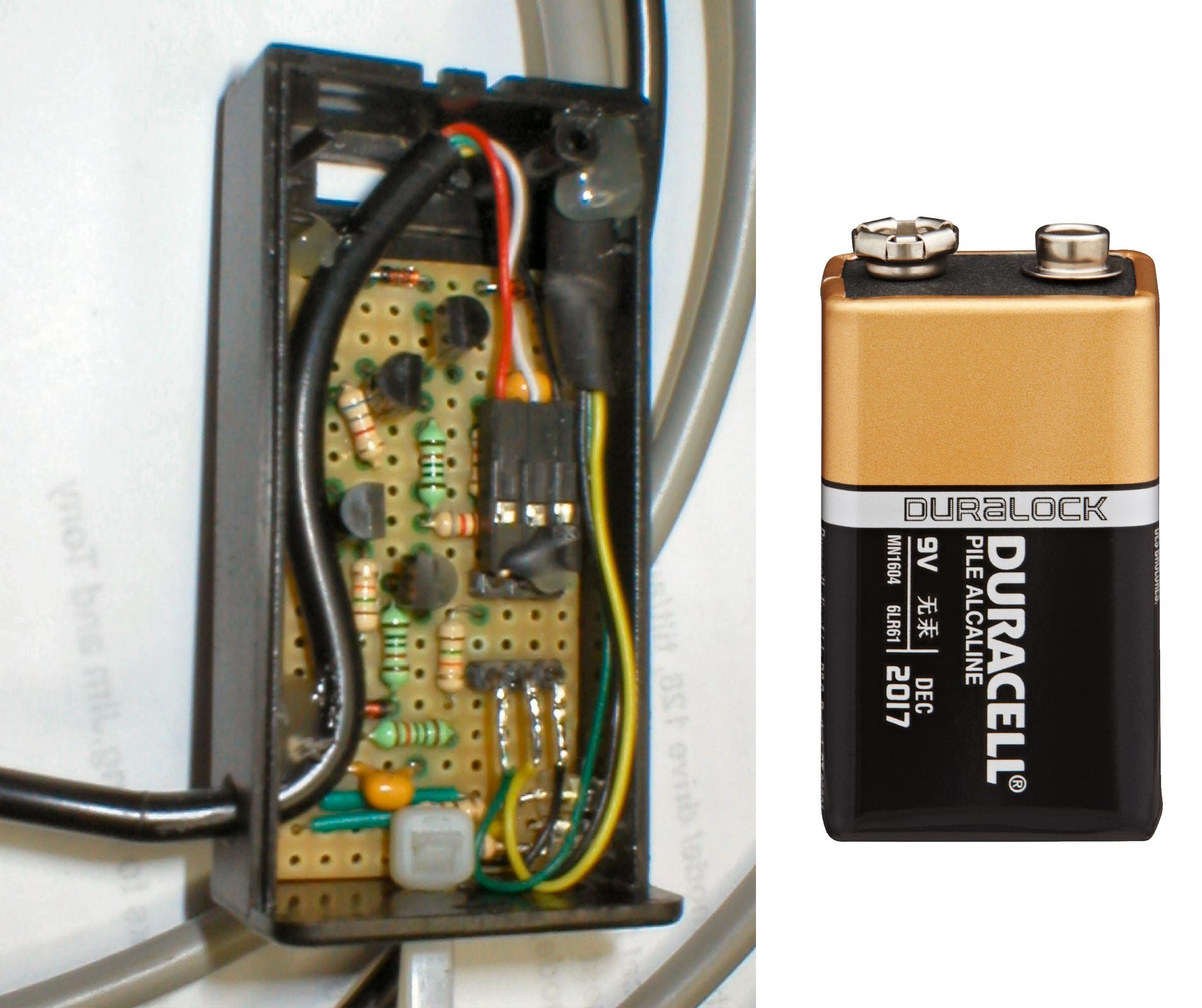

[quote="woodygb"]Vero / stripboard version of Anubis schematic.... note there is a small mod to the original schematic.
This fits into a 9v PP3 Battery holder box.

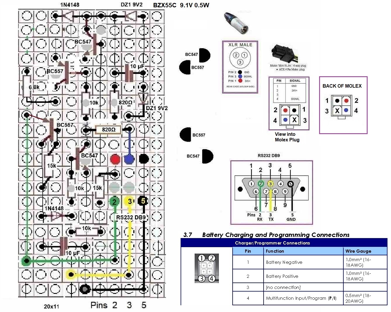

Postby woodygb » 08 Aug 2022, 16:11
I would suggest building this version.
Note that you MUST use the USB -TTL Adapter type shown in the pic.

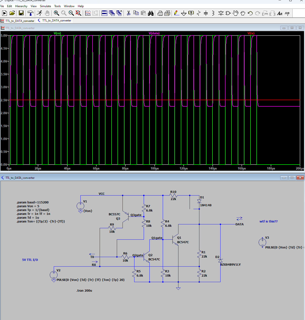

Hi Everyone -
I'm following along with this thread to get the software running and adapter built. I've ordered the relevant parts on digikey, and they should be here in a few days. I think I understand everything, except for the voltage levels on the one-wire DATA line on the Dynamic controller side of things. I put the adapter circuit into LTspice and it looks like the DATA signal is between 2.4V-5V when receiving. Is that right? (See uploaded image)
What's expected for the controller-TX case? I see the 9.1V zener there, and I assume there's a higher voltage protocol coming from the controller itself? 12V? 15V?

Re: DWIZ-ADAPT
Postby woodygb » 07 Sep 2024, 21:49
Quote from Anubis who devised the first adapter.
It may look like a RS-232 serial but it's not RS-232 standard.
It is Serial comunication alright but neither RS-232 nor TTL logic levels!
It's more like TTL-serial with CMOS voltage levels.

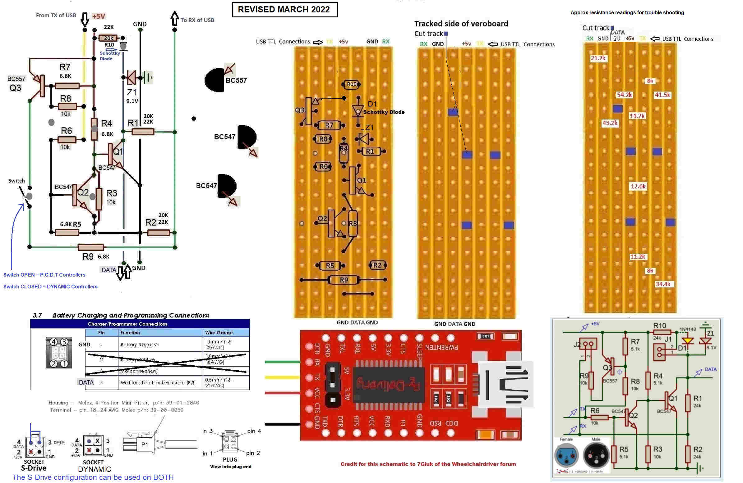

Re: DWIZ-ADAPT
Postby woodygb » 07 Sep 2024, 22:01
Here is a link to 7Gluk's original diagram without the addition of R10 & D1 and Switch for P.G.D.T. programming .
https://www.wheelchairdriver.com/board/ ... 40#p159436
Re: DWIZ-ADAPT
Postby Reliably9870 » 07 Sep 2024, 22:41
Ah, great. Thank you. I must have missed that page.
I realize now I had Rx/Tx swapped in my schematic above, but I'm still I'm curious what's really happening on the R-series side of all this with the weird protocol... Does anyone have pictures of the inside of one of these DR50/90s? I'm dying to know what the Inhibit/Programming pin is attached to. I did see a footnote in the R-series install manual stating, "It is the manufacturer's responsibility to ensure that any configurable interface pin that is to be used as a Battery Charger Inhibit pin is correctly configured and tested. The maximum voltage on the inhibit pin must not exceed 3 V if a battery voltage is to be detected when the battery charger is connected". Seems relevant, but not quite sure yet...

Re: DWIZ-ADAPT
Postby woodygb » 16 Sep 2024, 10:49
The Anubis schematic uses a SERIAL signal as the output.... So https://www.amazon.com/Serial-HL-340-RS ... B07WZTXQCJ should work fine.
7Gluks schematic uses a TTL signal as the output BUT you MUST use a specific board as mentioned HERE...
https://www.wheelchairdriver.com/board/ ... 40#p162180
NOTE:- I have tried multiple different USB adapter boards and chips... NOTHING else worked.
So you want THIS fake FTDI Board.
https://www.amazon.com/HiLetgo-FT232RL- ... B00IJXZQ7C

Postby woodygb » 16 Sep 2024, 17:53
Anubis veroboard layout and pinout.
Board in PP3 battery box.
