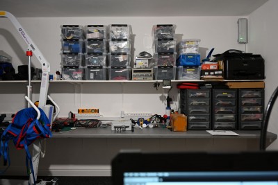

This is the question.
In the past I always have had a chair, usually an old one kicking around WITH a lift that I seldom used. Why? Because its useful occasionally when you know you are going to need to get up somewhere higher.
For e.g. look at my rooM, in the pics below. Much stuff on high up shelves. If I know I am doing something (like today) where I know I will need to access those boxes or things on the high shelves I will use a chair with a lift. Same if I am trying to clean my van. Or attempting to reach stuff on shelves in the garage. Also if I am going to somewhere I miht want to take some pictures!
But a lift has a lot of bad consequences.
It makes the chair way heavier. The lift module alone weighs an absolute tone. Worse it sets up high, and raises the user up another inch even if lowered as far as it goes. This causes enough issues as it is for battery performance, stabiliy, caster shake likelyhood, reliability, and the feel of the chair. It also causes the chair to feel "flexible" and not solid and rigid. Even when down.
So MOST of the time I prefer to use a much lighter more nomble rigid feeling chair. Its just ncer to use.
Now if like me you have a bunch of chairs to choose from, then you will want a chair with lift. Preferably 300mm or more. For the times when its important. And chairs without for when you are busy and going places!
However theres some reasons why you may NEED lift all the time. For e.g if you have say dressing bench, sofa, bed all at different heights in order to transfer. Or in order to empty a legbag into a toilet. Personally I used to just go outside! But thats not always possible.
What about you?

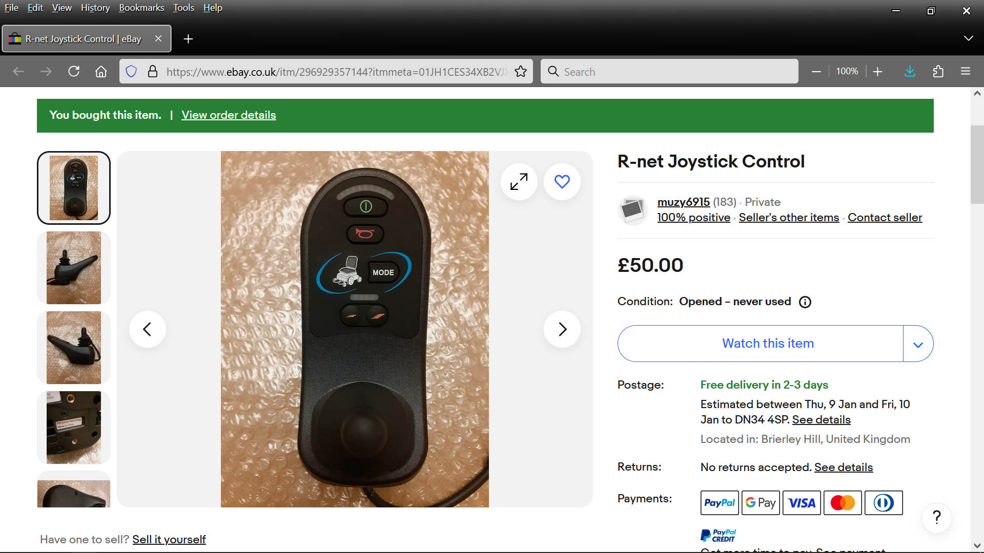

Postby Burgerman » 27 Mar 2025, 17:01
Or cheaper?
I paid £50.

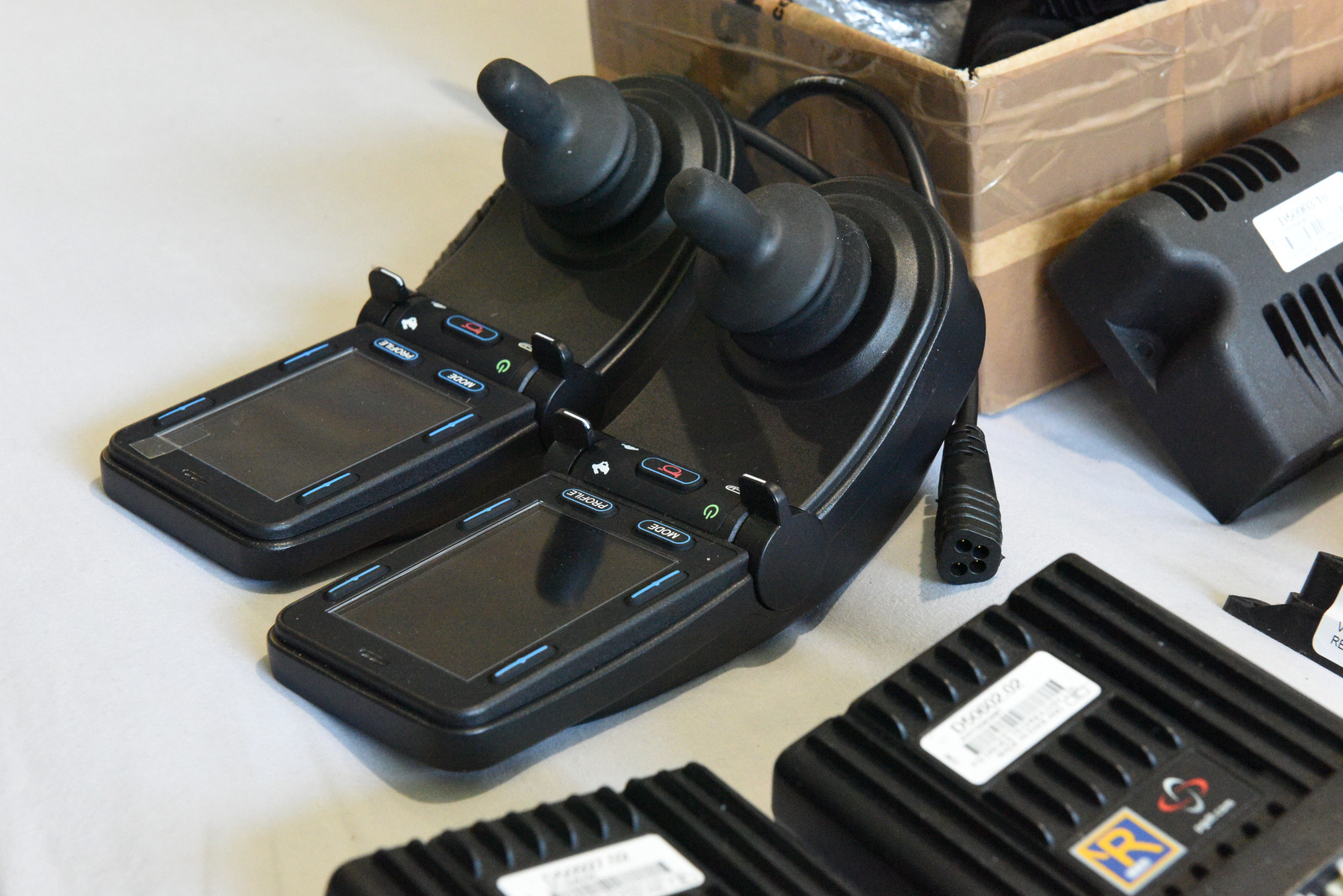

I have a lot of spares bought this way. Some of it here.
All joysticks new. Some of the power modules used but as good as new.
But to use it you need a programmer. And thats around £300. I have one obvously to match my 3 R-Net chairs. Its 300 essential well spent cash.

Wow, that’s really nice to know there are options on eBay to get the joysticks and control units.
There is 1 thing I don’t understand: you said that it is necessary a 300€ programmer, but I thought that a cable and software was enough.
