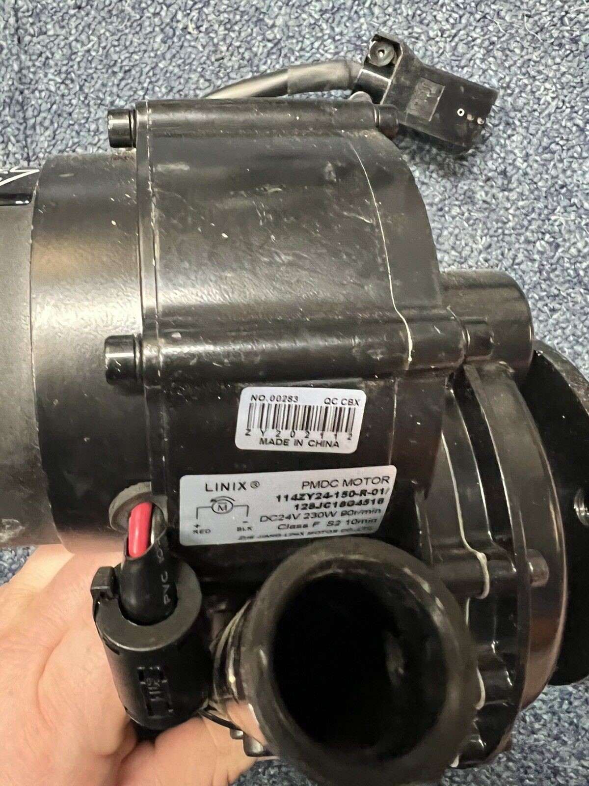

Postby hank » 21 Jan 2025, 15:36
Hi
Could anyone tell me if a Quickie Q50R lightweight wheelchair uses brushed motors
What i want to do is fit R net joystick plus PM to make it steer properly
looking for a lightweight indoor chair to replace my manual one as getting weaker now
Re: Controllers for lightweight chairs
Postby emilevirus » 21 Jan 2025, 15:43
PMDC is brushed. 2 wire is brushed.

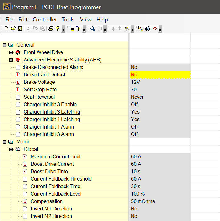

Just ordered the connectors for motor & battery along with a led joystick. Will let you know how it goes. Mine doesn't have electromagnetic brakes so I'll need to disable that.
emilevirus
Posts: 563
Joined: 12 Aug 2020, 22:02
Postby Burgerman » 22 Jan 2025, 01:32
Never tried it but disable these top two...
Postby emilevirus » 22 Jan 2025, 01:39
Current limit can't be lower than 50A but if I set power limit to 50%, that should limit it to 25A right?
