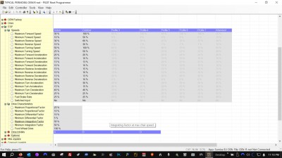

I'm trying to set up Cruise Control on the Permobil F5.

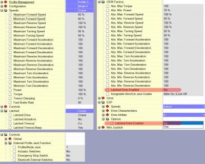

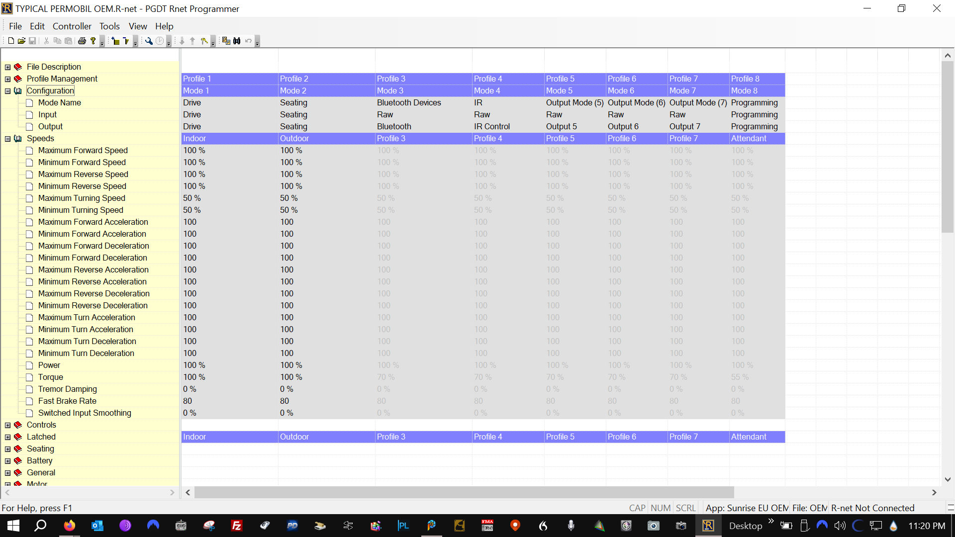

I created a profile, activated it, and made the changes as shown in the screenshots below. But the profile does not behave like Cruise — it acts like a regular profile.
As I understand it, the Latched Drive Enabled option (highlighted in red) needs to be set to Yes. But as soon as I change its value from No to Yes, the wheelchair displays Error 1201.
What am I doing wrong?
The configuration file I’m working with is attached.
Thank you.

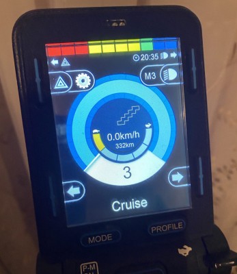

It works perfectly on the Quickie Q700. And if we figure out the cause of the 1201 error, it will work on the Permobil as well. See link
youtu.be/rZ9zndTjzGk

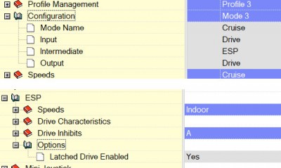

1201 relates to bad settings in the esp module. you need to enable latched under esp/options
Re: Cruise Control in Permobil F5
Postby sergey0 » 03 Oct 2025, 15:29
rover220 wrote:1201 relates to bad settings in the esp module. you need to enable latched under esp/options
I set it to Yes in OEM Factory only, and I also tried setting it to Yes in both OEM Factory and ESP at the same time. The result is the same — error 1201.

1. I’m not a supporter of making any changes to the technical components that would violate what the wheelchair manufacturer’s engineers have designed.
2. I still managed to get Cruise working correctly. The screenshots of what else needs to be changed are below. OEM Factory / Latched Drive Enabled should be left set to No.

I saw no video. Its locked or unavailable.
But the Q700 can be 4mph (6kph) or HD 4mph using 5mph (8kph) 4 pole motors, 6mph (10kph) 4 pole programmed for 4 in some cases, 8mph 4 pole (13kph) 4 pole which are low torque... All 2 and 4 pole linix. Options depend where you live and how you buy.
Best setup compromise is 120A R-net with 6mph 10kph 4 pole on every chair though. With a big lithium pack...
I never played with latched controls. For 2 reasons. It worries me... And I presumed it only works with non proportional controls. Because otherwise its not logical. So a button or a mouth tube etc. At least thats what was intended.
OK I fixed the vid so I can watch it.
That scares me. Exactly what I expected. See above.
How did you stop it?
How does it steer without your hand? Because otherwise whats the point of it?
Seems like a great way to accidentally drive into a wall or off the train platform... No thanks! :shock:

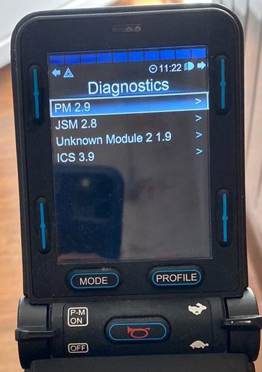

a) gyro related stuff is not DEALER level. So that DEALER level On Board Programming wouldnt let you configure it anyway.
b) the joystick is PG Drives, a CJSM2. the power module where the joystick talks to, is PG drives, the permobil made gyro isnt... So the joysticks on board programming hasnt heard of it!
c) in the PC software its possible to see the permobil gyro, and the special "permobil speeds" settings section. And you shouldnt mess with the speeds settings in the normal place at the top of the menu like other chairsAnd the programmer can read that and change the settings. But its hard to make it much better.
The power module has extended firmware that undestands the permobil gyro.
At the top, where all normal chairs settings are adjusted. On a permobil they look mighty odd! And shouldnt be changed.
On a permobil with their own gyro theres an extra place added to the menue much lower down under ESP where you adjust these things. And below that
the gyro settings. I recommend you leave these alone. You can change stuff, and it changes the way it drives a bit... But not in a good way or predictably if you are trying to get linear control. Why? No idea.
This is for te permobil gyrro chairs - lower down, doesent exist on R-Net only systems. And the only place you should adjust anything.

What software and hardware are you using to try to reprogram your Permobil?
Posts: 4105
Postby sergey0 » 08 Oct 2025, 12:58
martin007 wrote:sergey0!
R-Net Permobil Software + R-Net Dongle
