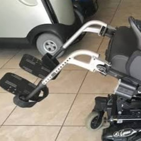

Postby faico_26 » 18 Oct 2025, 20:15
Here the legrest.
faico_26

Joined: 14 Sep 2018, 12:21
Re: Legrest spring too hard
Postby faico_26 » 18 Oct 2025, 20:16
Another pic.

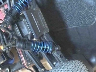

Postby faico_26 » 19 Oct 2025, 22:41
The “donor”
faico_26
