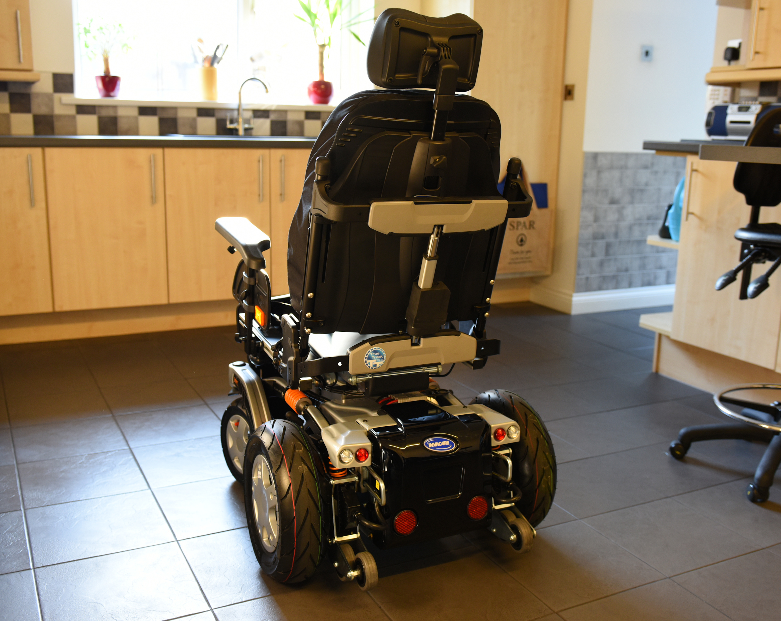

Before... Martin my carer having a rest! 24.5 wide.

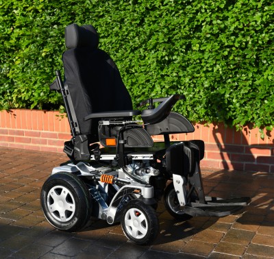

After the above modifications/programming and now 27.0 wide.
Posts: 71096
Re: Invacare TDX SP 2 NB (Narrow Base)
Postby Burgerman » 31 May 2017, 20:56
Some more after pics... As these come, they are unusable, from programming to being way, way too nose heavy.
But a few minor changes and it transforms them.
Its covered in dust here. But otherwise used once before these pics taken.

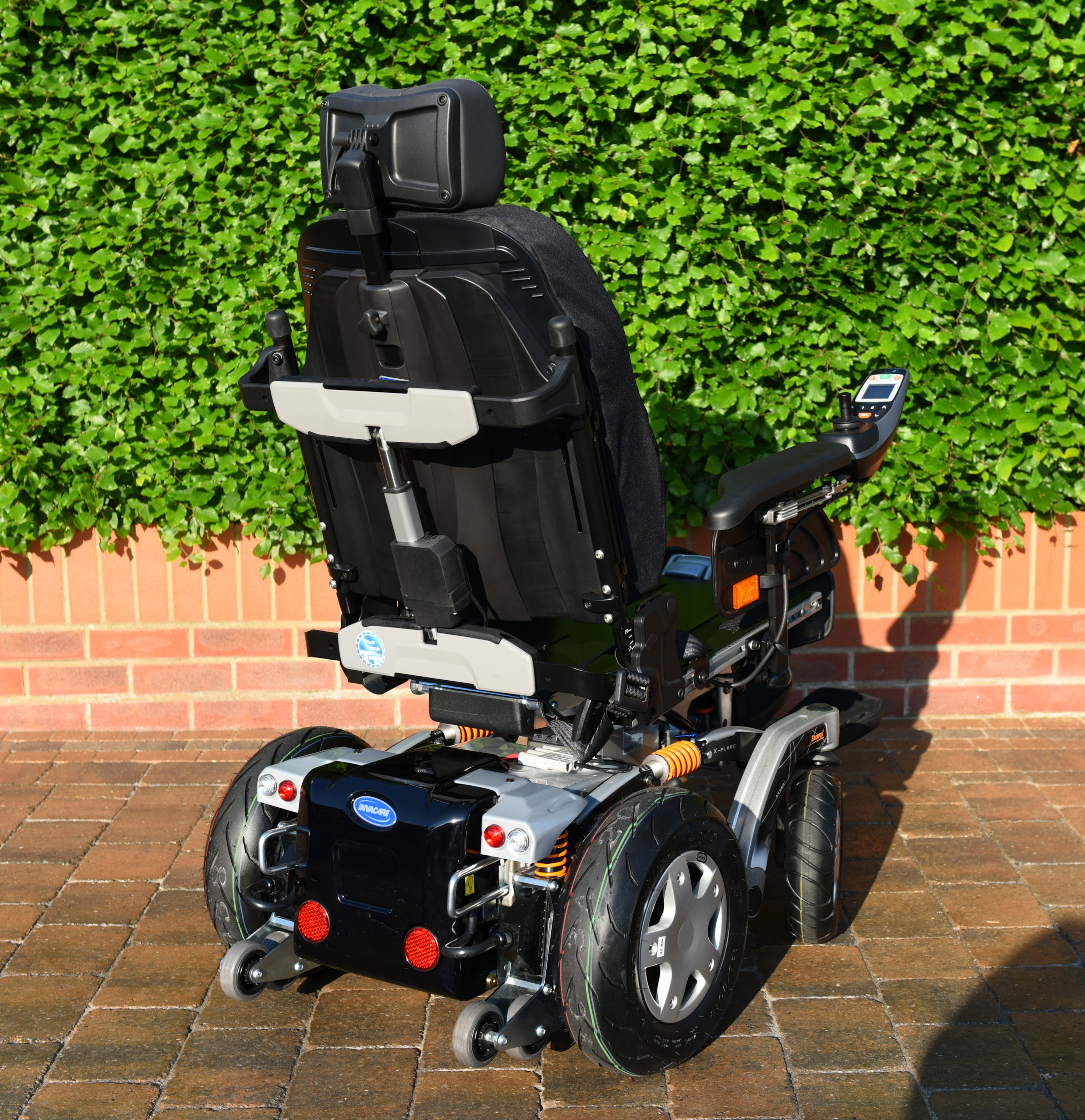

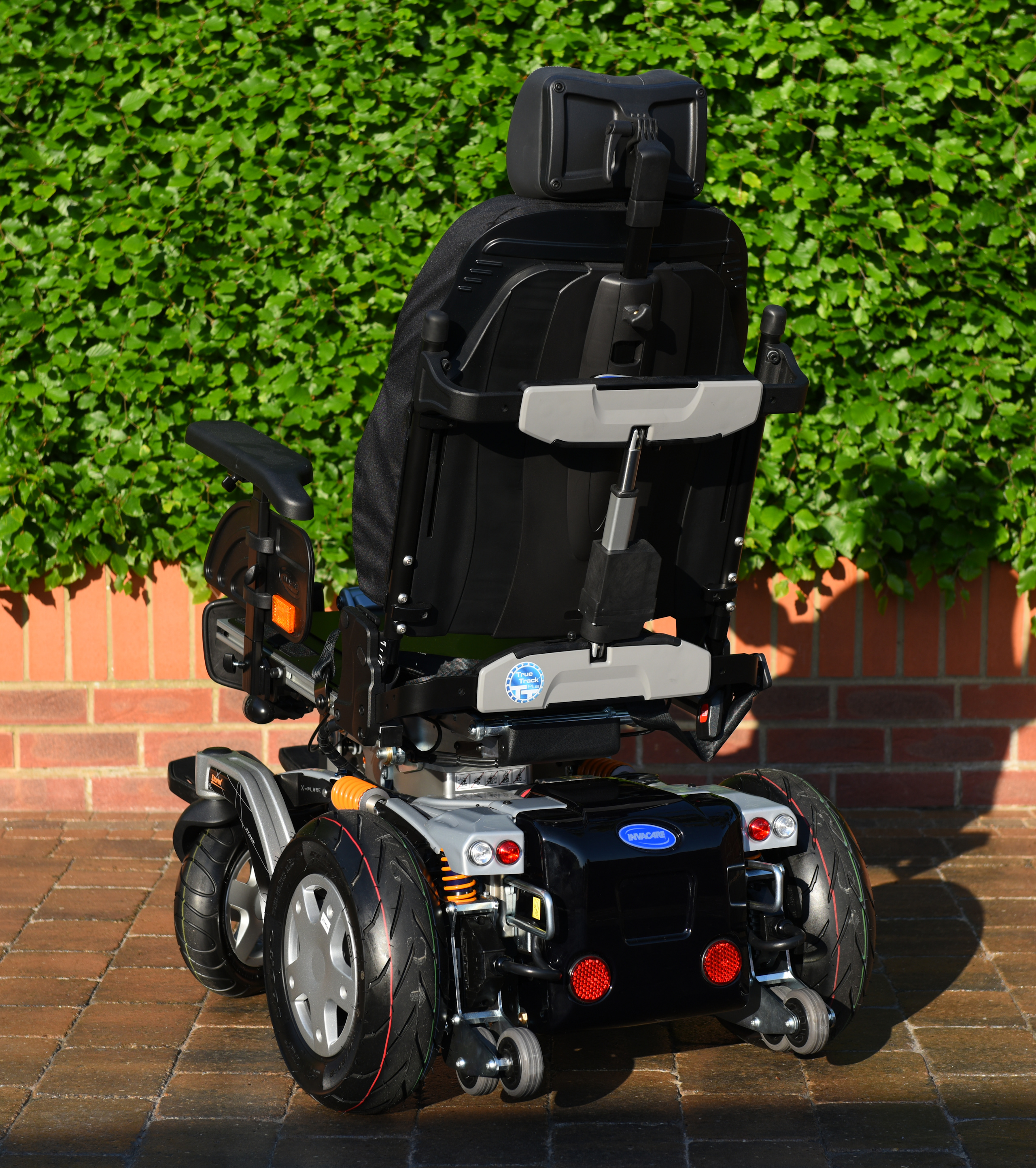

Rear... Click for bigger.
Posts: 71096

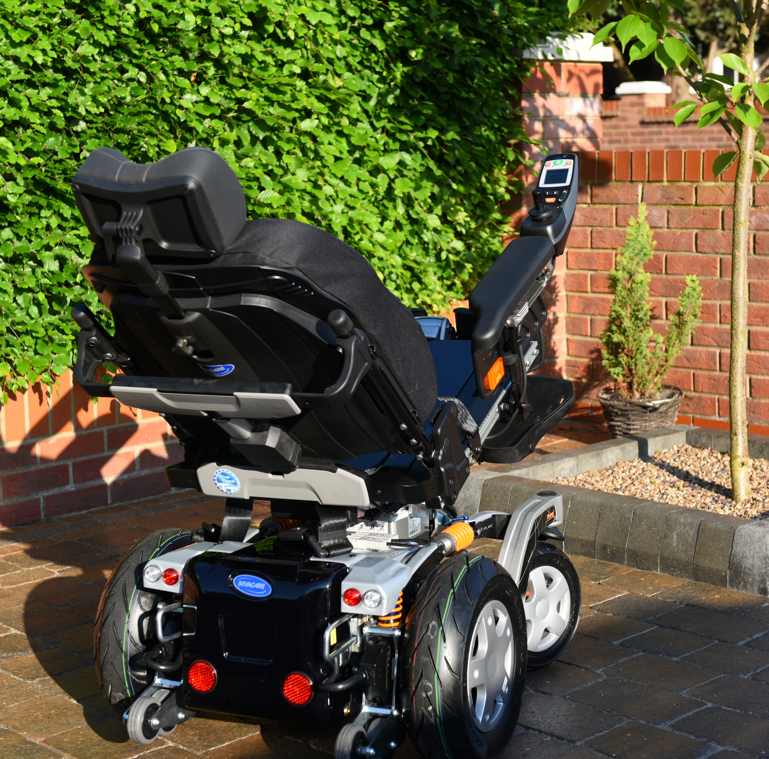

Other way...
Posts: 71096

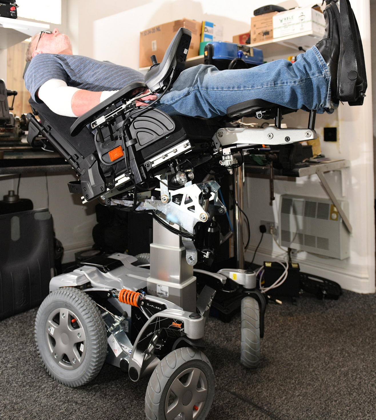

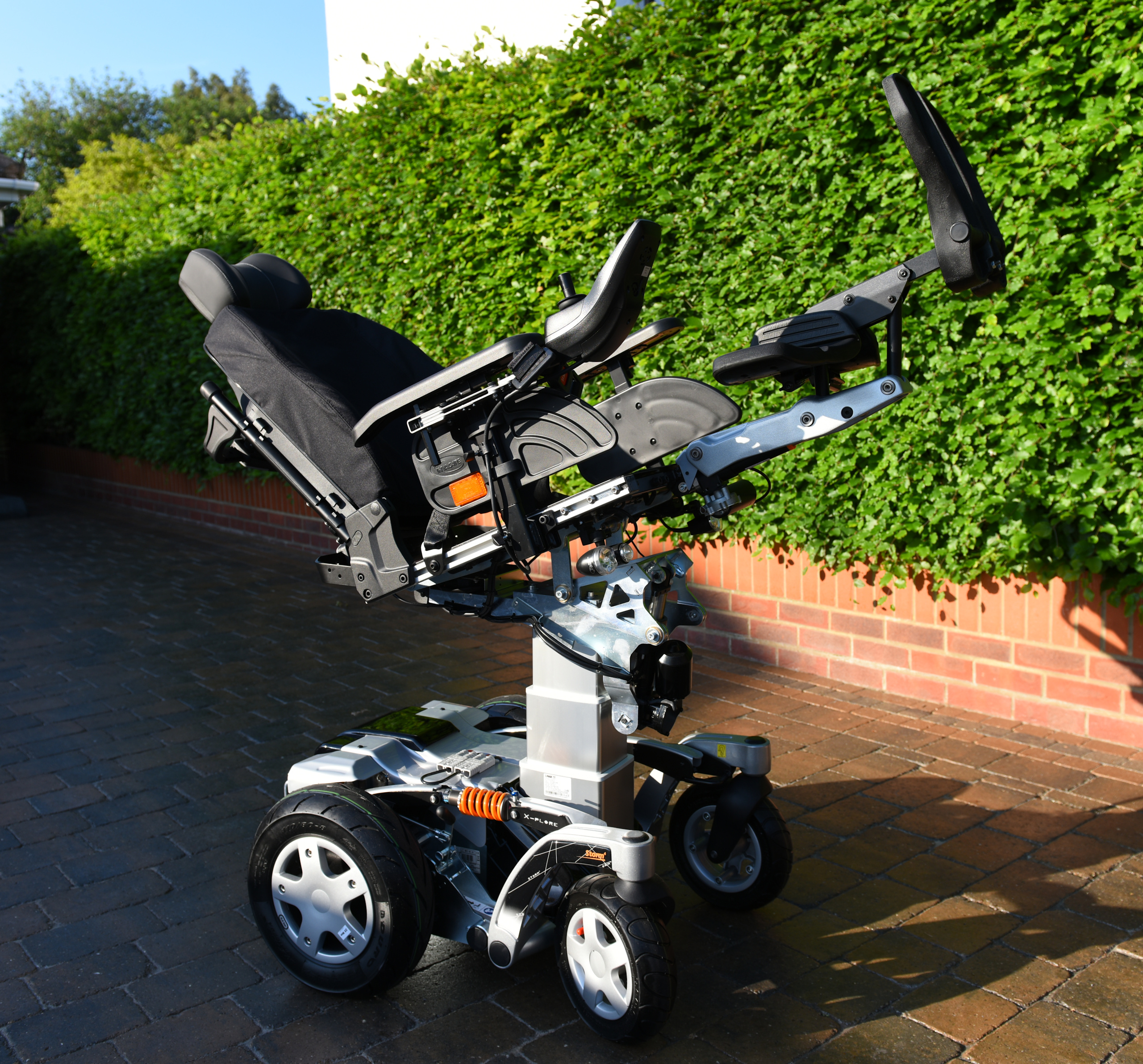

Another... Max Tilt. If I am not active, and sit all day as in winter I get sores. This tilt thing helps transfer weight and gives my backside a rest.
Posts: 71096

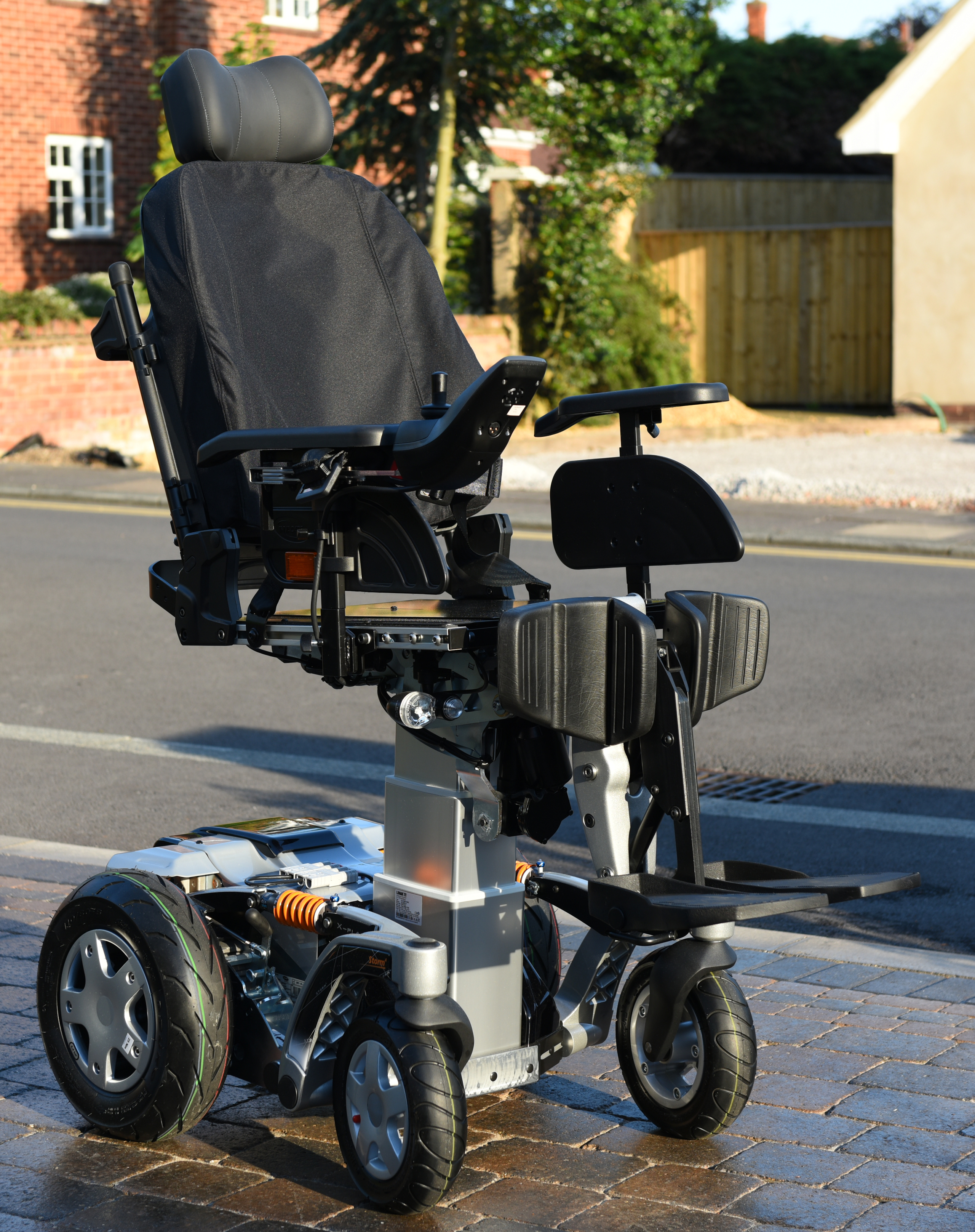

And it goes up! And because I have a programmer it can go faster than a crawl... So is useful to reach or clean now and again.
Posts: 71096

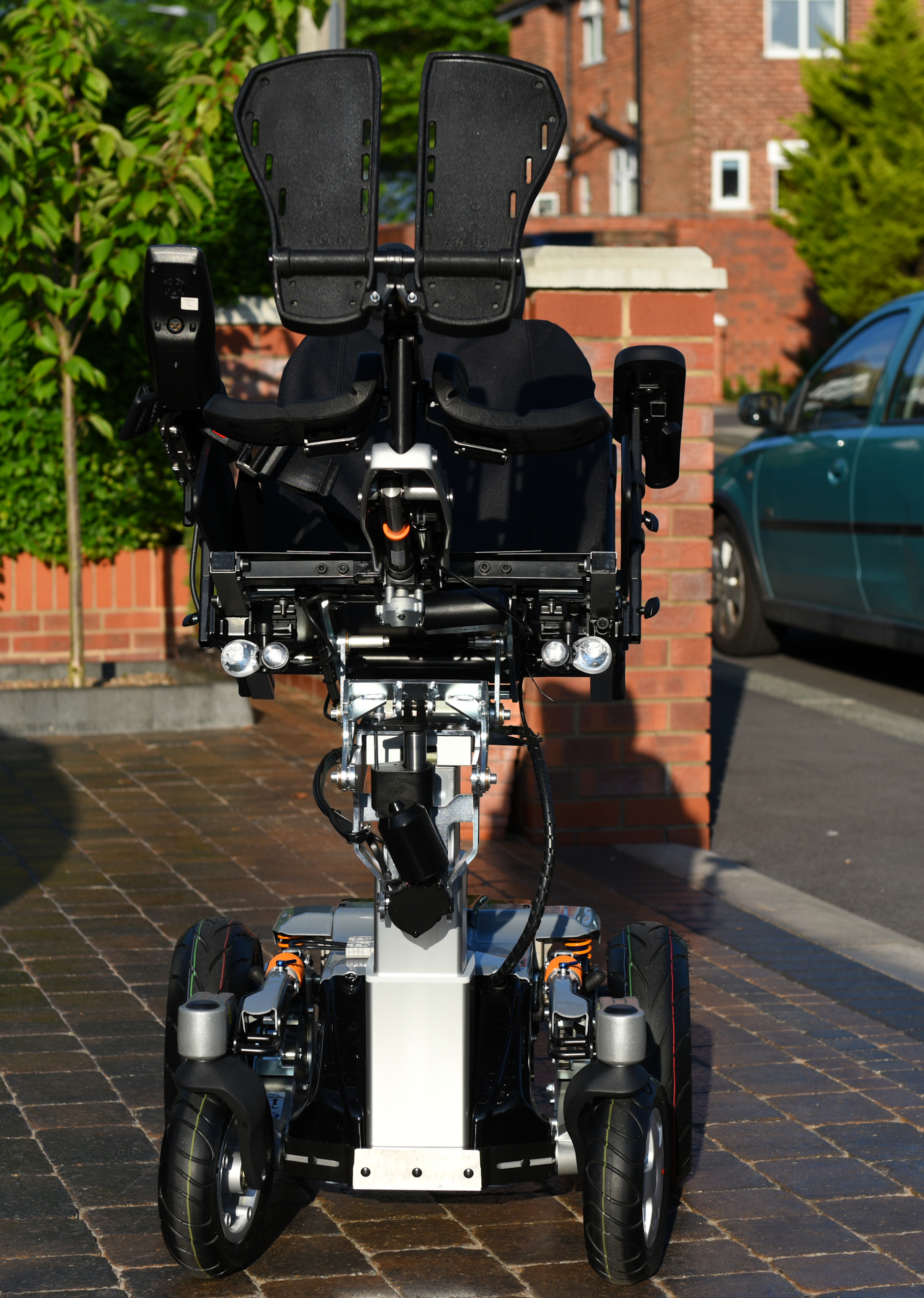

Front...

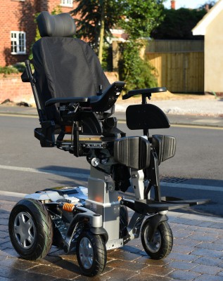

side

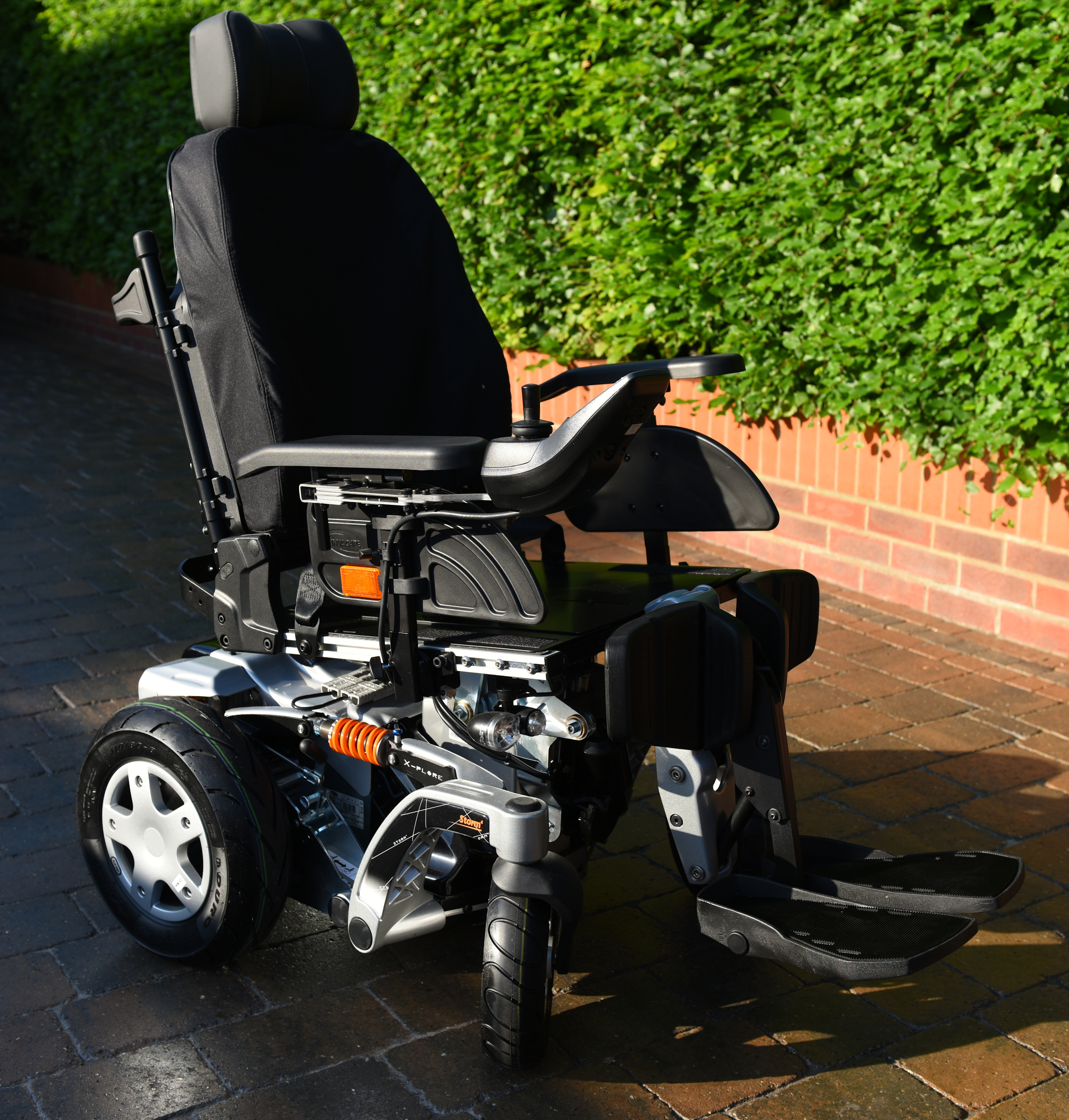

Normal position.
8mph, (bit more with these bigger tyres), latest 3rd generation brushless so has a great 59km or 37 miles of range on its lead batteries. (And about 3x that when converted to lithium as soon as possible. So around 100 mile range!)
Its suspension on all 4 wheels, and bigger rear pneumatic tyres, mean its got probably the best pavement ride of any chair I ever tested. And the suspension is linked. It allows the chair to stay level as the surface pitches and feels like a boat! All highly adjustable. About 7k to your door.
Posts: 71096
